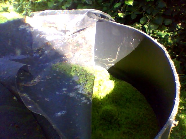

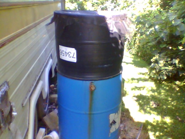

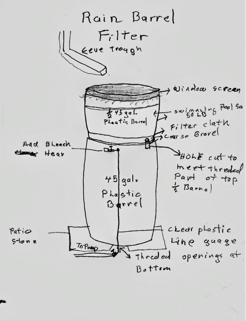

# Posted: 18 Jul 2015 10:39am
SOOOO this green moss grows on top of my filter bed , not sure what it,s called ,but it works . The system has been up and running for 8 years . Water is always clear and sweet , we drink it after boiling. I add 1 tbs of bleach weekly . the tank is drained during winter months.
