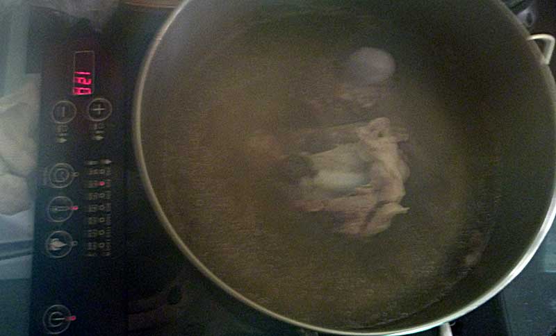

here is my induction cooker simmering away.
my solar system has charged the batteries already, so I am on float. The system is using 120 watts to maintain float with no loads.
I have set the induction cooker by temperature (120C as you can see, which means it should be using 400 watts). it cycles off and on. I will post the power usage once the broth is done. but as of now the cooker appears to be drawing about 700 watts when it is on.
update: I just hit the one hour mark. according to my EM100 I have used 340 watts. the 120C mark should be a rolling simmer. but it's not, no boil in fact. I have to use the 150 mark. where I get a slightly too vigorous boil.
I'm not liking the Salton. If I were to buy another induction cooker it will have more temperature selections.
I will point out: The cost to run the cooker, as my batteries are already charged and the sun is out, is effectively 0.
With solar. once your batteries are charged. all power you use until the sun goes down comes direct from the sun. there is no cost. In fact, it's part of getting your money's worth.
This also points to one of the advantages of Lithium batteries. Because they don't care if they are partially discharged, you only need be concerned with maintaining a healthy charge level between say 50 and 90%. this means you can use heavy loads at night and you're not diminishing the lifespan of your batteries in the same way you would be with lead acid.
As I have a lead acid battery pack. I try to schedule my heavy loads for the afternoon of sunny days. I know my batteries are charged and the power I use comes not from the batteries but directly from the sun.
# Posted: 24 Jul 2015 04:07pm
Final tally. Ham bones. $3.40. Two hours, 740 watts of simmering supplied by my solar system. Free.
Turning the sun into ham stock. how delicious.
