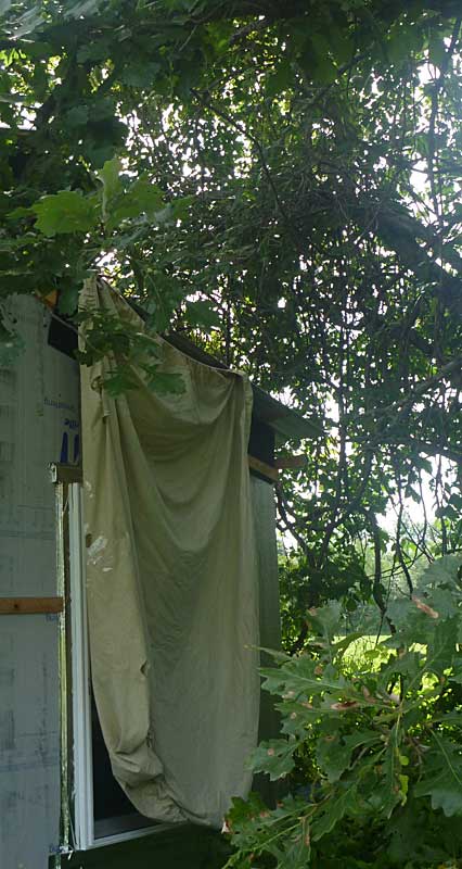

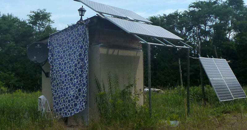

 My solar shed, sheet one. The sheet keeps that mid/late west sun off the door and wall. Results are a drop in battery temps of 4 degrees and the inverter is no longer running its fan.
 Sheet two is the bedroom. No results to speak of as I just put it up. But it will keep the late afternoon sun out of the biggest window. As you can see from the tree and wild grape leaves, its pretty shaded and actually stays comfortable on its own.

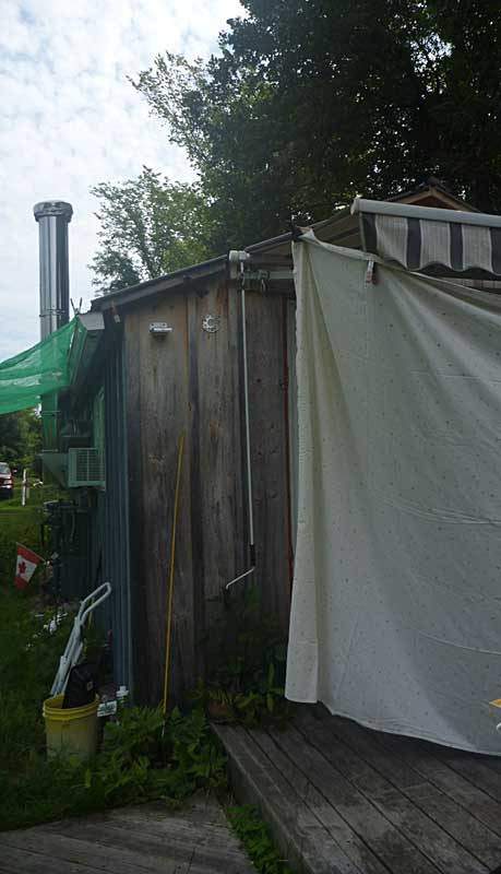

 Sheet three is for my studio. Note the green shade cloth over the air conditioner also. The sheet is keeping the sun from hitting the doors in the late afternoon. It also keeps the deck from burning my feet when I step outside.

 I cool the buildings at night. Close them up during the day. No mystery there. Keep the sun off. I continue to be able to keep my batteries under 30C. Yesterday I ran the a/c from 4 to 6 in the studio, that was fine. And the bedroom stayed comfortable. Mostly due to insulation and tree provided shade.
 Steve that's a neat idea. I might try shading the roof on the studio or increase ventilation in the attic next. Thx for the ideas.
