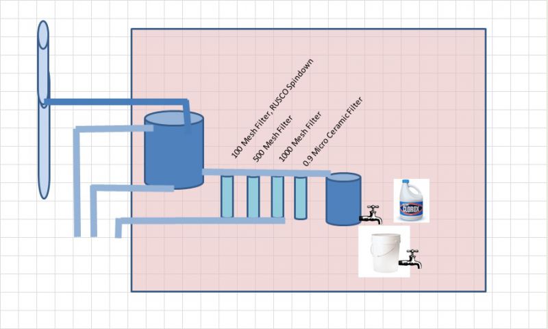

FYI Best practices for roof water for drinking include; a first flush device, four water filters inline and plain Clorox bleach in the final stage.
