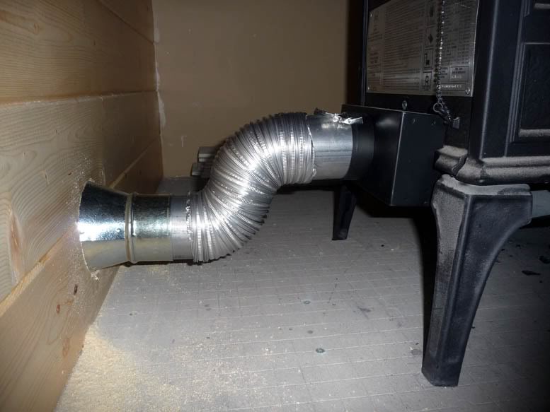

# Posted: 24 Oct 2010 01:12am
Some wood stoves have fresh air kits available. Others you can build one for. Basically it consists of a metal shroud that surrounds the air intake and connects to the exterior.
Here's the one that is an option for the VC Aspen stove.
3" aluminum duct
3" aluminum duct

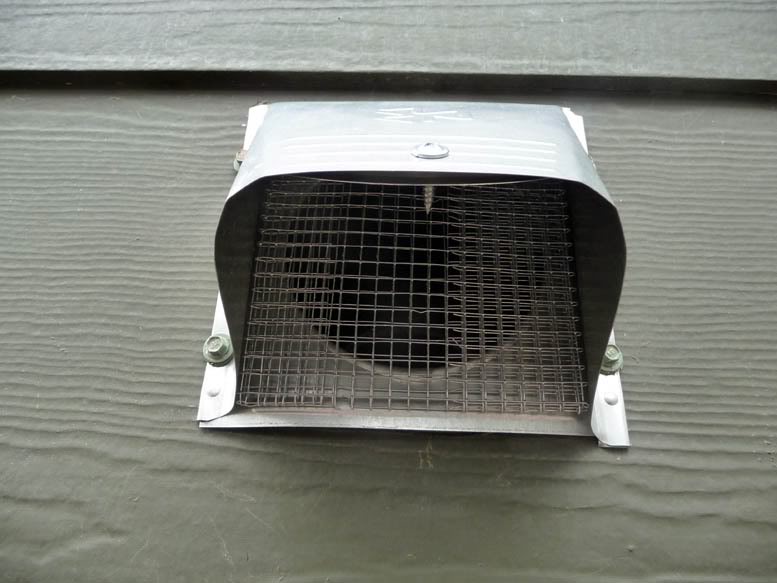

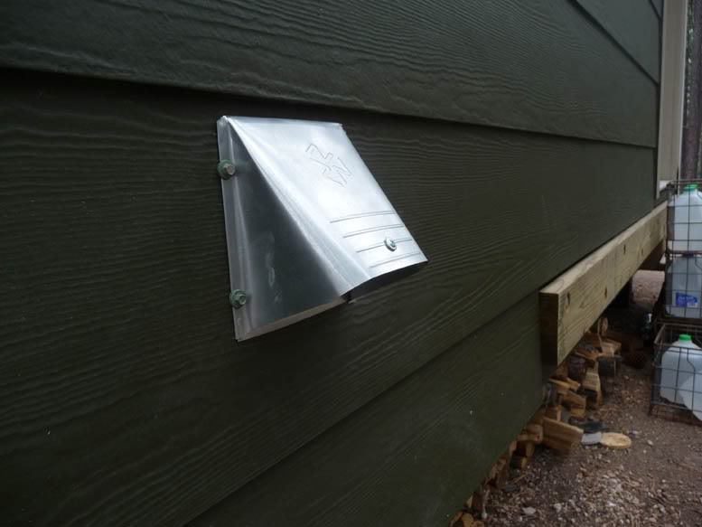

the exterior inlet shroud (modified dryer vent)
Added screen to discourage mice and a screw to hold the flap up
