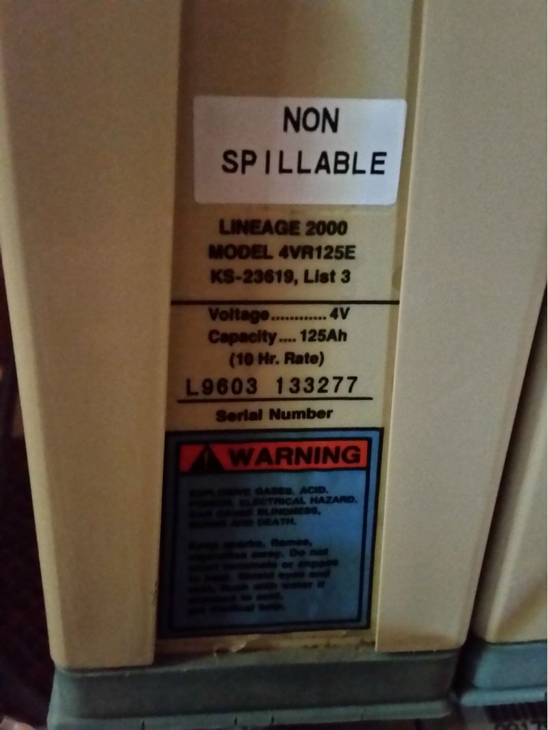

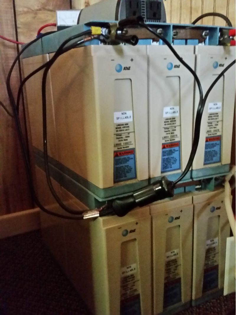

I have 12 very old 4v. batteries wired series/parallel on my system. They recharge OK if in ample sunlight and still give decent service, but now that fall is here and the sun angle is lower I am relying more on my EU2000i so I don't constantly drag these batteries down.
I am planning to upgrade my system, but in the meanwhile how can I best take advantage of the generator to recharge these batteries without damaging them?
I wouldn't think a direct connection between the generator and the batteries is advisable without some sort of line protection.
I do have a Schumacher float charger. I use this at home to maintain my deep cycle battery which I use on the water pump at camp. Could I use this at camp with alligator clips and directly charge my solar batteries?
I'm trying to keep this question simple but if I've overlooked any info I'd certainly appreciate hearing.

Twelve 4 volt... wired for what system volts? 12, 24.....
# Posted: 7 Oct 2015 05:13pm - Edited by: MtnDon
I see they are rated at 125 AH. Is there mfg info on the recommended charge rate? Listed as "xx" amps or as a function of capacity. "C"... like C/10....
These were here when I bought the place and they date back to 1998/1999! They still work!
They were, ummm, borrowed, from an AT&T cell phone tower when the phone company did an upgrade (seriously, they weren't stolen, but the guy had some connections). I have no info on them unless I turn them over and find more stickers!!!
Soooo, I have nothing on this to share.

Sold under the Lucent name; they make all sorts od cell tower equipment. Batteries made by Deka. Valve regulated battery which is basically an AGM type. That means being careful about maximum charge rate is important.
Google found info sheets with everything but the cgarge rate! ???
One data sheet here
Another
# Posted: 7 Oct 2015 06:33pm
Here's more info right from Lucent, 1998.....
There's charge info in that but I can't seem to find an amp rate.... in a rush as we have a dinner date.......

Quoting: creeky
you're using a 12v charger I assume
My Schumacher is supposed to read 6v. or 12 v. and adjust accordingly, AFAIK. I will check the manual on this.
Quoting: creeky
best to charge the two sets of 3 one set at a time.
Maybe hard to see on the photos but I have buss bar connections. I'd think that would be an awful PITA to disassemble and reassemble every time I want to charge up.

bobrok. to me it looks like the three batteries are tied together into one set. the two sets are then linked with longer cables.
you could charge one set (of 3) at a time. but it's probably not necessary.

You are correct in how the batteries are harnessed, but I'd still have to make disconnections from each gang every time I want to charge, plus my charging times will triple since I have three sets.

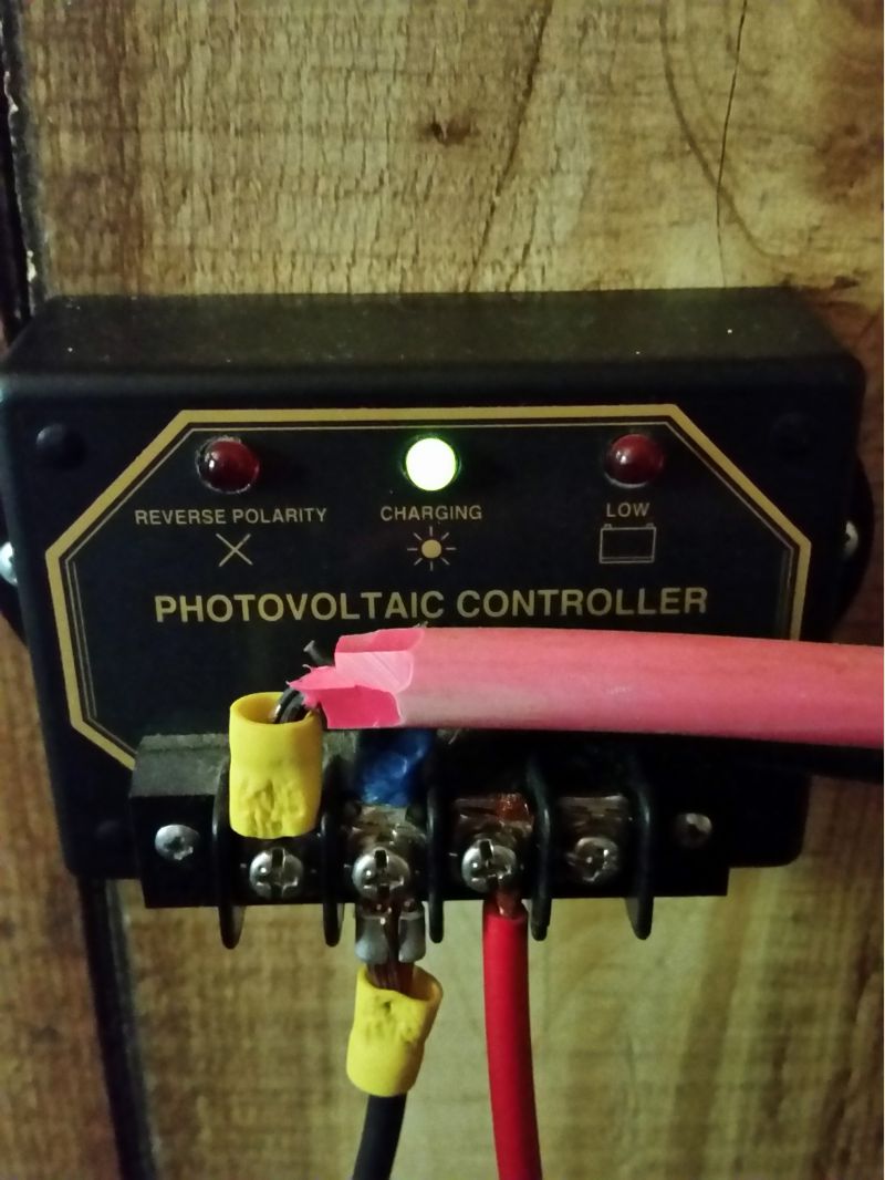

My panel and charge controller are as ancient as my batteries and charge in full direct sun only at 2.25 - 3 amps maximum. This slow charge rate could be why everything has lasted so long. My guess.
As an aside, I used to keep my original Schumacher (same model) plugged into a power receptacle when I was using the generator for power tools. I'd leave it plugged in permanently to charge up my deep cycle battery for the water pump.
It blew up after a while. I guess it couldn't take the constant surges and off/on cycles of the generator. I no longer do this.
controller
controller

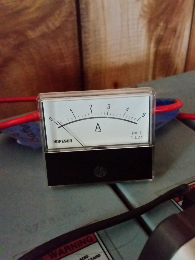

amp meter
amp meter

ya. it's not worth disconnecting the parallel strings. You should have a bus for the four strings tho. to keep the loads/charging distributed between the parallel strings better. do you?
I missed that you had 4 sets of 3. The pic only showed two sets. heh heh heh.
it would be interesting to do a capacity test on those batteries. I mean 4 parallel strings at 125 amps means you may have 500 amps of storage there. somehow I'm thinking reality is a little lower.

Yeah, I have a dozen 4v. units. The second set is behind the first. They weigh a ton!

I don't mean to belabor this thread, but I'm reading the manual for my charger URL and it says that the output current rating at 12v. is 1.5A.
My solar panel charges at no more than 3.25A at maximum and usually hovers at a midpoint around the 1.5A - 2A range before dropping off to roughly .25A at maintenance.
Since the outputs are so similar shouldn't I be able to use the charger?
The only concern I have is that while charging at any output the PV controller will constantly cycle to "0" output for a second before resuming charge. I figure that's some sort of protection built in.
Would it work to run my charger thru the PV controller (probably disconnecting the panel while doing this)?
Or am I playing with trouble?
Tnx.
# Posted: 10 Oct 2015 12:18pm
run the charger full on. that thing is not the best for your use. (ps. that's classic creeky understatement )
with those batteries and that size. you are wwwwwaaaaayyyyy over batteried and under charging.
you could put a 50 amp charge into those guys. well. when they were new. you should probably beg or borrow a better charger.
