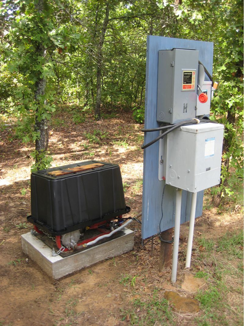

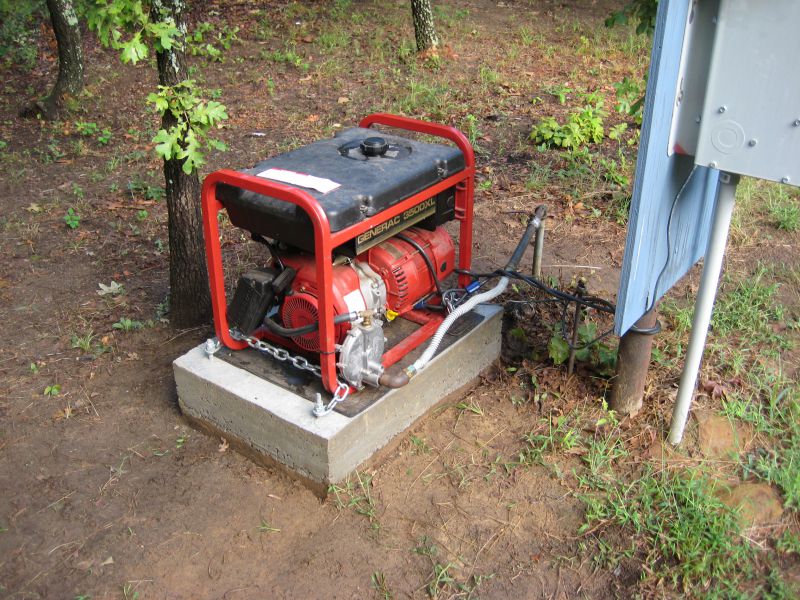

I rigged-up a backup generator for the cabin, but it's not the full feature auto set-up that you have noted. Since 30 amps will easily run everything possible, and I had available a Generac 3500XL converted to run on natural gas, I simply poured a concrete pad, added a disconnect and it was done. Manual start-up simply requires opening the gas valve, flipping two disconnect levers and a pull or two to start the genset. And since I have natural gas from wells on the property, fuel is no cost.
'Nothing wrong with the full feature backup units, but total installed cost can be somewhat pricey. backup generator
