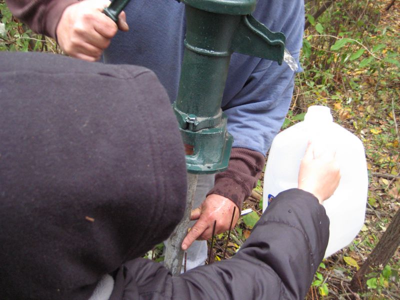

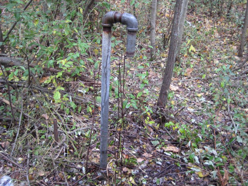

We have several acres that are very woody with some dense areas of under brush. About a week ago, we happened to stumble on a shallow well pipe! We checked it out today. We don't know much about wells. We took the curve pipe off and attached a pitcher pump and it worked. We also dropped a line and sinker down. We would guess it's only about 10 feet deep. I'm really excited that we have water to clean with... what are the chances that it might be drinkable? It isn't near any visible problem areas. Thanks! IMG_0378.JPG

# Posted: 17 Oct 2015 06:39pm
I would guess that a well only that deep doesn't stand much chance of producing drinkable water. It must be taking surface water, and that means bacteria. When I put in my well the health department required a concrete seal around the pipe to a depth of 20 feet to keep surface water out.
When wells are drilled, usually there is a requirement to record what happened when it was done. Your local health dept. may have such a record- when drilled, how deep, rate of flow, etc. Worth making a call to find out. They are probably the best ones to tell you if it's drinkable, too, cause they know the local conditions.
It's cheap to have the water tested by a local lab for bacteria.
What luck to stumble across an unknown well!

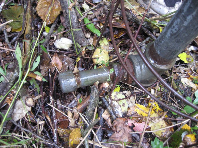

Anyone know what the little pipe coming off the bottom is for?
# Posted: 17 Oct 2015 09:49pm - Edited by: hattie
Our well is only 14 ft deep and is a dug well. It is very drinkable. We run a small motel and use that water for drinking, watering the gardens, showers, laundry, and everything else you use water for. We get it tested regularly and have never had a bad reading. We've had really dry weather here this past year (and other years) and the well has never run dry. Just because it is shallow doesn't mean it isn't drinkable. I'd get it tested and find out for sure.
The side pipe is probably for draining it in the winter so it won't freeze.

ChuckDynasty
# Posted: 18 Oct 2015 01:44pm
For what it's worth...since it's a shallow well that may not be sealed, a good test today may not mean the water quality will be the same down the road. I'd filter it regardless, doesn't hurt. Great find!
