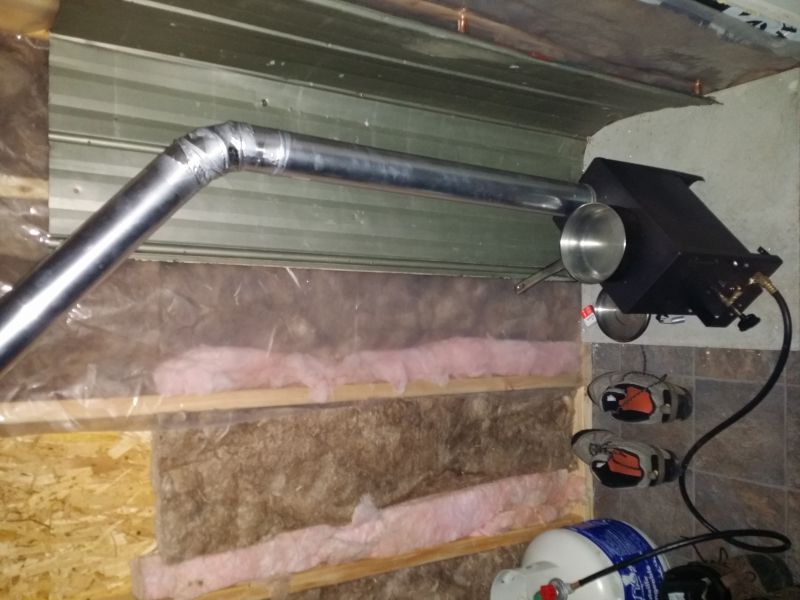

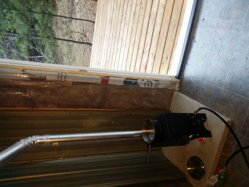

 Well howdy neighbour! Funny that one of my main sources of information in starting this journey happens to be in the same region. Thank you humbly for creating what has turned into such a cool and open community/wealth of knowledge... and humour!
 ... and into the heater stuff. I got it installed this weekend and it works great. Was a little chilly in the evenings but sure didn't feel it in the cabin. We were nice and toasty while heading out for our grouse hunts in the morning. Now that the heat is sorted it definitely makes the place feel much more established and a better viable option for a winter getaway. Next stop in the developments is indoor siding.

| 1300_stainless Member
 | # Posted: 17 Nov 2015 01:16pm Reply
 Glad to see you're up and running!
