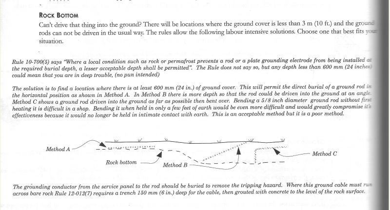

 Over the weekend I tried to drive my 8ft ground rod into the ground but unfortunately there is a bed of sand stone about 4 ft deep which I can't break through.  What other options do I have to ground my cabin?  Can I cut the ground rod in half and drive the two 4ft sections next to each other and then tie them together with a jumper?

 Hopefully this helps.  Scanned the tiny section out of one of my electrical code guides... It's not USA but likely quite similar.  Hope it's of use.
 As opposed to an 8' Rod, have you considered using a large Grounding Plate ?  Something like this Galvanized Ground Plate C/W Connector

 You can also try up to a 45 degree angle or bury the rod in a horizontal trench. NEC in US indicates 30" depth minimum
 mikeholt.com info link
 see (G) and (H)

 Drive it in at an angle.
 I think code has changed in my area, they want 2 of them, so many feet apart and the solid ground wire bonded to both of them

 The idea is to get as much earth contact as possible, as deep as possible, so that you have as little resistance as possible. Moisture in the earth helps conducting so the deeper you go the better. If you are planning to put in any trenches for pipe or foundations you can add more grounding later by putting rebar or #2 copper wire in the trench.
 The electrical code says to bond anything that can function as an electrode to the grounding electrode system, such as metal water pipes, rebar in footings, etc. Actually a ground rod is one of the worst earth connections just because it is so small and has less area. But usually it's good enough if driven the whole 8 feet, cause it will probably hit moist earth.
