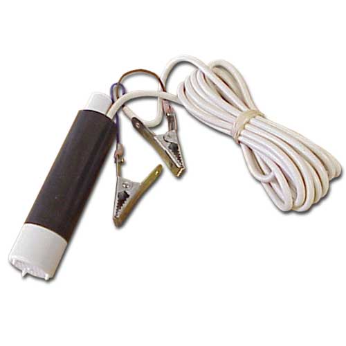

 I had another idea that might work much better for your situation.  Google "12V submersible pump" and look for one like the picture below.  These will fit in a 2 inch well and you simply clip the leads to a 12v battery and the pump runs.
 To use it, remove your current pump and piping, clear all the water out and store for the winter.  Attach a suitable sized tubing to the submersible pump with a hose clamp.  Lower the pump down the well until it is submerged in the water column.  Secure the electrical wires and tubing to the side of the well casing to hold the pump in place.
 When you need water, take a battery and your jugs out to the well house, stick the end of the tubing in a jug and clip the pump wires onto the battery.  When done filling the jugs, unclip the wires from the battery.  The pump will stop running and, even better, the water will drain back through the pump.  It will pull the remaining water in the tubing back down as well.
 Nothing to freeze or to keep warm.  You will need to know how far down the water level in the well is and purchase a pump that is rated for that height.

 Quoting: NorthRick   Google "12V submersible pump" and look for one like the picture below.  These will fit in a 2 inch well and you simply clip the leads to a 12v battery and the pump runs.this I will do

 I'll get that skinny pump

 Google Rule IL200, IL280 and IL500.  They make those pumps. Designed as a bilge pump for marine use they don't perform well when confronted with a lot of rise. The 200 (200 GPH with no rise) drops to about a gallon a minute when pushing the water up 15 feet. There are a couple of higher capacity models; IL280 and IL500.
 Grainger sells them. Amazon and West Marine also sell them. Worth a google if you don't need to lift the water more than 30 feet. And 30 feet will be slow delivery with the model IL200. Performance Chart at West Marine
 The IL200 size has 2 versions. The one with the suffix P, is continuous duty. I don't recall what the duty cycle on the intermittent model is. I have had an IL200P for about 3 or 4 years now.

 Quoting: MtnDon Google Rule IL200, IL280 and IL500. They make those pumps. Designed as a bilge pump for marine use they don't perform well when confronted with a lot of rise. The 200 (200 GPH with no rise) drops to about a gallon a minute when pushing the water up 15 feet. There are a couple of higher capacity models; IL280 and IL500.
 Depending upon how high you have to raise the water, you may need two of the IL500 pumps installed inline, 8 feet apart.
 They are pretty handy items to have around. One pump can be dedicated to transferring heating oil, &c. Another for showering, for example...
