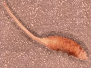

If you have "water" standing in the pit for long periods of time what you will get is a highly enriched (eutrophic) untreated sewage slurry which may, I say may, be a breeding ground for beasties ie aquatic bugs that can survive in such anaerobic "aquatic" habitats. There is a regular occurrence of calls from picnic grounds where the pit toilets become invested with rat tailed maggots (Syrphidae) crawling out of the pit to pupate. Seems to gross patrons out and put them off their visitations.
These little guys range about an inch long with a 2 inch tail. They breathe through the tail sticking out of the slurry so they can munch on the errr particles and bits.
Sorry for the lecture.
