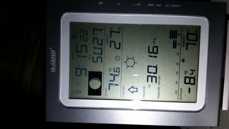

 | # Posted: 2 Mar 2016 02:38pm Reply
 I took this pic in late Dec. 2015. This was in a 28x12 shed cabin(gable roof) with batt insulation (R13 walls R21 ceiling) with a lopi 440T woodstove burning pine.  This is after about 5 hours of the fire being started.
