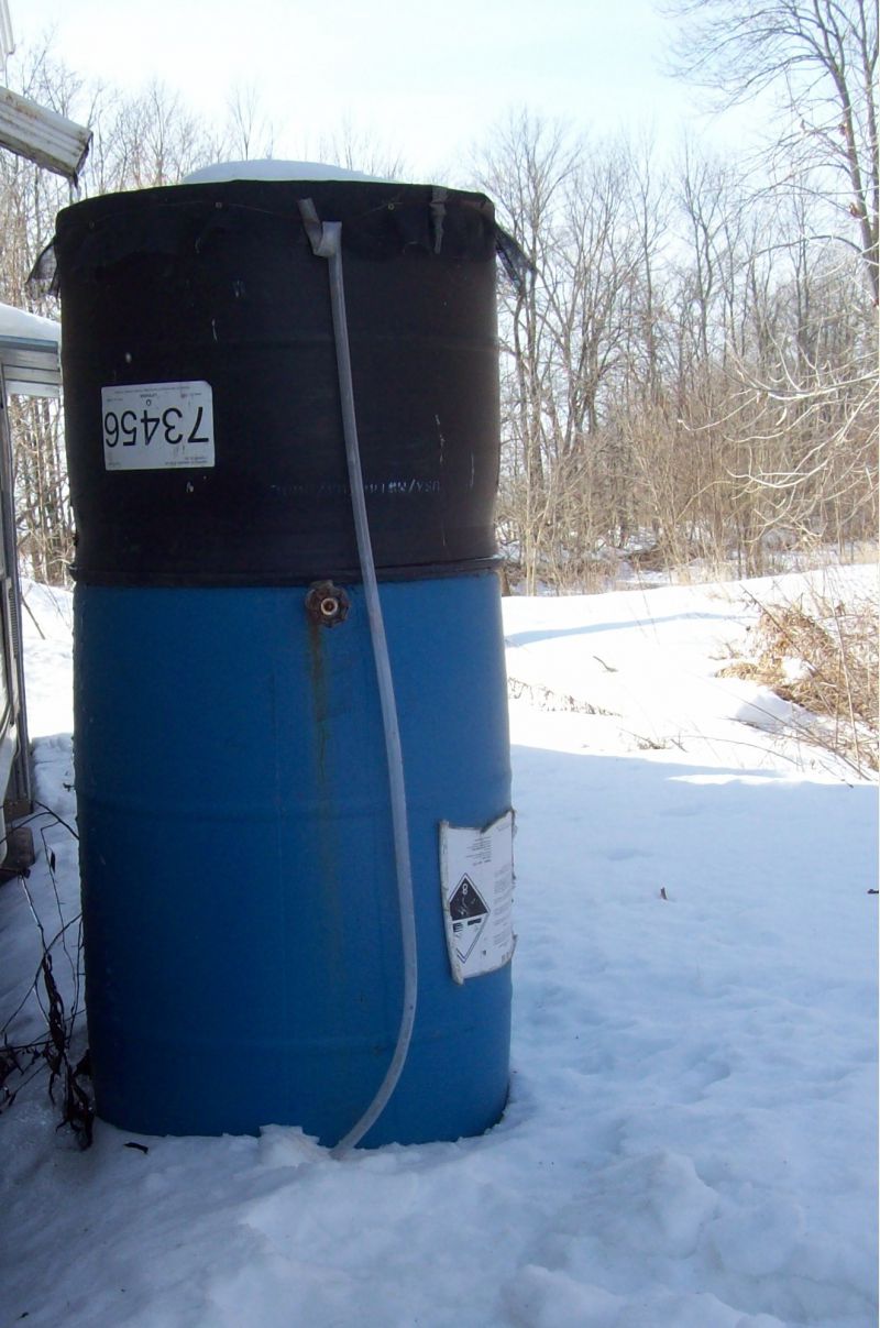

 In your OP you said you had 120 volt a/c power. So keeping your water system from freezing should be easy for you. I posted a few pics to possibly help julie2oregons question: hand pump and electric rv faucets post.
 If you enclose your water tank and put a light bulb inside, it should keep it from freezing up between visits. You can put heat tape on your water supply lines.

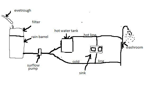

| Just Member
 | # Posted: 4 Jan 2016 07:48pm Reply
 this is what I have..
| Smawgunner Member
 | # Posted: 4 Jan 2016 08:17pm Reply
 That's exactly what I had in mind Just. Do you deal with freeze or draining your system in preparation for freeze?
| Just Member
 | # Posted: 4 Jan 2016 08:31pm Reply
 we drain come winter as we only use the place a bit  in winter .

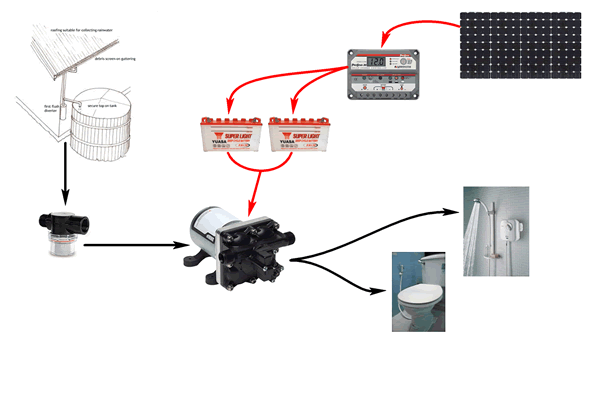

 Here's ours, basically. This is how we get water for shower and such in the province, at our farm. It's been working that way for over two years, now. No issues. (Oh, no cold / ice / snow to concern ourselves with, as we live in the tropics.)

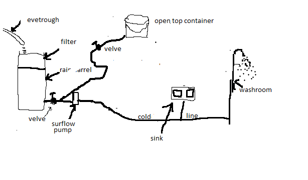

 I don't mean to hijack this thread, but I'd like some clarification on the hot water part of these systems. In the systems described here, does the hot water tank or container need to be sealed in order to maintain pressure?
 The reason I ask is I've learned over the past couple of years that my hot water needs are minimal--a couple of gallons for a navy shower or to wash dishes, and that's it for the day. Depending on the time of day, I could see how a pot of water heated on a stove in the morning or a container left in the sun all day would satisfy my hot water needs. Ideally, I'd like a system where an on-demand pump would pull cold water at any time, but would also allow me to pour a couple of gallons of hot water into some sort of container to mix with the cold water as needed for those one or two times a day I want hot water.
 I'm guessing I'd need a completely separate plumbing system and pump for the hot water, but wondered if there's a way to do it with the same pump as the cold water side.

 ILFE, what's that first piece after the cistern?  A filter?

 I don't see why that would not work. That's what I'm going for. It would be just like "JUST" posted above. Similar to an RV set up. A pump would pull water from a storage take. One line goes to the cold and one line goes to a hot water tank or on demand system. Then you should be all set. I'm guessing as I'm not familiar with the system,..that the pump would kick on when the shower knob is turned on.

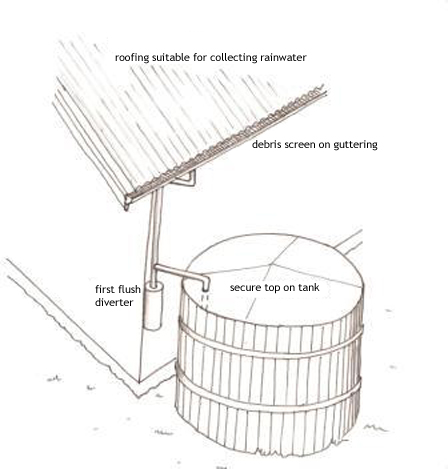

 Quoting: NorthRick ILFE, what's that first piece after the cistern? A filter?
 That's a typical first flush system. The one on the side of our farm house is actually considerably larger.
 The first X liters (gallons) of rain need to be flushed, or diverted into a separate containment area, prior to the rest of the water being sent to your storage tanks. It just helps guarantee that you are starting with cleaner water.
 On our system, we currently use rainwater jars, here in Cambodia, for storage. I will be changing over to poly tanks once I move out to the farm full time, to store higher volumes of water.
 EDIT: I'm sorry, man. It's almost 2am here. I just realized you were talking about the 50 micron strainer between the cistern and the ShurFlo pump. It's just to keep larger bits of trash from going into the impeller of the pump. It should be able to pass anything smaller than 50 microns, easily, and without damage. Sorry about that.

 Here is a larger version of that same image:

 Yes, the strainer was what I was referring to.

 Quoting: buckybuck to be sealed in order to maintain pressure? You may be able to change a system like mine if the pump is able to handle hot water. I am not sure a surflow pump will handle warm water. IF it could, you could heat a pot of hot water on the stove and then pump the warm water into your pluming ..ie HOT SHOWER.....
| buckybuck Member
 | # Posted: 7 Jan 2016 05:49pm Reply
 I've used an on-demand pump cobbled to a Zodi water heater, so I'm sure it'll handle the temperatures I'm anticipating. I'm basically trying to figure out a real-looking plumbing system without over-engineering it.
 RV plumbing systems work on the concept that there's a little bit of pressure in the pipes when no water is running, right? And the pump kicks on when the pressure drops (you turn on a faucet)? I can visualize how to put a pump between a 55-gallon water drum and the cold water faucets and have it work. But I don't want or need an RV type hot water tank--in RVs, isn't the hot water tank part of that slightly pressurized plumbing system? Instead, I'm thinking maybe a water container of some sort under the sink and a hose from it to the hot water faucets. The idea is to fill that container with hot water before taking a shower (an indoor, temperature-adjustable shower stall is a wifey/granddaughter demand) and be able to mix that warm water with the cold water in order to adjust the water temperature. I don't want to have to pressurize that container under the sink The only way I see to do this is to have a separate on-demand pump for the hot water side, which really isn't a terrible solution. Just another pump.
 (I know that a little on-demand water heater would be the ideal solution. If I were a full-timer or had electricity I'd probably go that route.)
