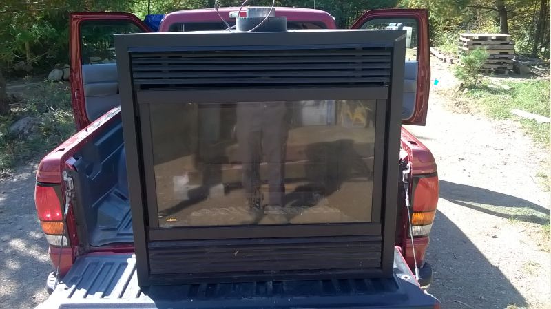

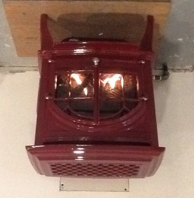

 We have installed an enviro-fire  Ascot enamelled gas direct vent unit.  Personally I wouldn't trust a ventless even with a co detector.  This unit will heat 1000 sq. feet and us made in canada with Canadian approvals.  It has a mili volt ignition and puts out lots of heat.  It also has a circulation fan but that us not required for operation.  It's a nice looking unit too and not large.  Approved for close clearances.  Photo of unit attached.

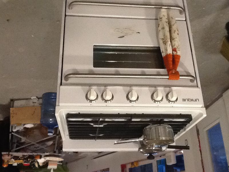

 Sorry that one loaded upside down.  We also have installed a  "Unique" gas range which us designed to be off grid.  I will load a picture if that too!
| Dekagoldwingers Member
 | # Posted: 2 Jan 2016 03:54pm Reply
 Sorry I rotated it and it still loads upside down!

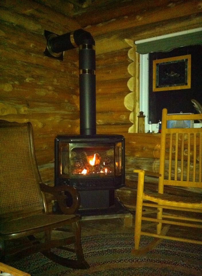

 We have a propane off grid vented CSA approved stove that was installed by a licenced installer. It is by Napoleon. Our cabin is in Canada.
 It is sized to heat our cabin but because we have not insulated (log) it is a waste to bother running it unless its no colder than 55F.
 Before we ordered it from the local home improvement store we told them our requirements and they set us up with the correct stove.
| silverwaterlady Member
 | # Posted: 2 Jan 2016 04:38pm Reply
 Here is a photo:

 I picked up a Majestic/Vermont Castings DVRT-36 Propane Fireplace (direct vent) with millivolt thermostat control and piezo ignitor for $250 off Kijiji which was made in Mississauga
 I'd suggest looking in Kijiji, possibly even placing a "Wanted" advert in there... it's free...  you may get lucky and hit someone who is renovating.
 Here is one in Petawawa by the base Free Standing propane Firepace $350  (this popped up for me as it's within my general area)
 This is the one I got myself.
 Hope it helps
 |  Majestic DVRT-36 Fireplace
