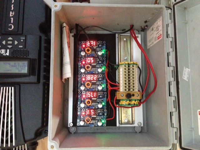

Al Burton
# Posted: 27 Jan 2016 02:57pm
Here is what I used to get rid of all my "wall warts". I run 24vdc from my battery bank in then run small dc-dc converters for each voltage I need. You do need to watch maximum power ratings. These are cheap and so far have been working perfectly for about 2 years.
http://www.ebay.com/itm/DC-LM2596-4-0-40-to-1-3-37V-LED-Voltmeter-Buck-Step-down-Powe r-Converter-Module-/261713002463?hash=item3cef4f7fdf:g:GnsAAOSwiCRUj5Cc
Al Burton
# Posted: 27 Jan 2016 02:59pm
Here is a picture of my set-up.
Al Burton
# Posted: 27 Jan 2016 03:00pm
Why do my pics always post upside down? lol
SE Ohio
# Posted: 27 Jan 2016 03:27pm
Al,
Those DC-DC step-down converters are cheaper than the cost of the LM-337-based circuit parts, plus have extra features (e.g. idiot diode!). Very nice. I'm guessing you spent more on the project box than the parts in it!

buckybuck
# Posted: 27 Jan 2016 04:23pm
Ooooo. LEDs and nixie tube. I likee. I just ordered two.
How do you handle devices powered by USB? Do you just sacrifice an old female USB plug and wire it to the converter?
