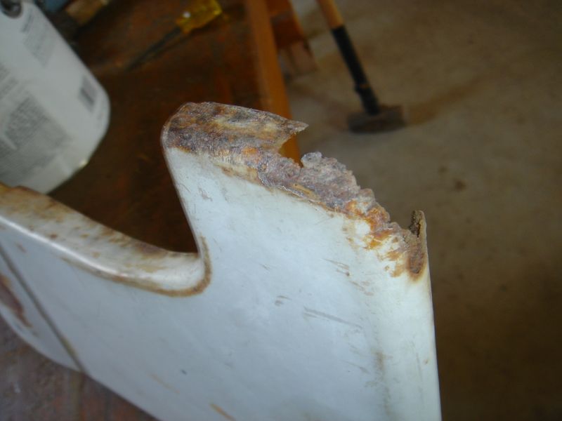

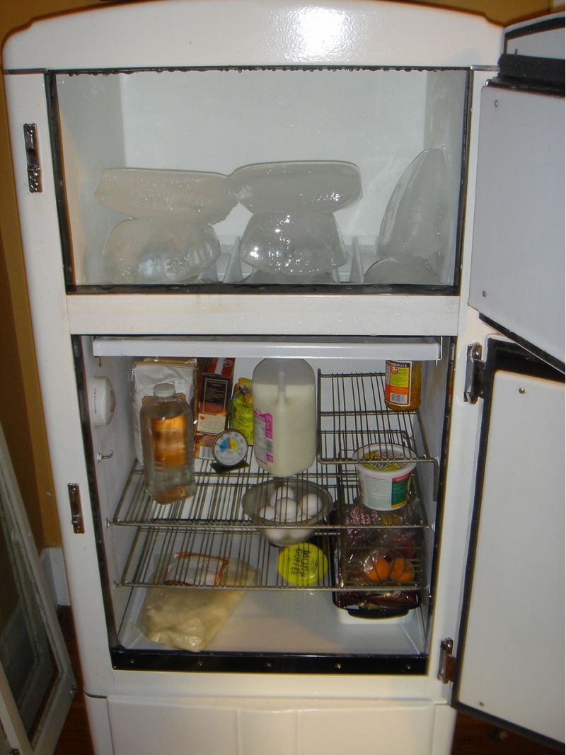

Among the many things I am interested in is Ice Refrigerators. Granted I live on power and have been making my own larger ice blocks from a upright freezer that keeps ahead of my late model Coolerator Ice Box I restored from a wreck. This time of year it runs for usually 6 days on the four blocks I make for it. I have always wanted to find or create a smaller more efficient box just to see if I could get one to run longer cooling a smaller area and using less ice. I have about 50 of those blue ice blocks I purchased thinking at one point they would be a good way to cool without a drain pan. But what I found was that real ice blocks drop the temperature by about 5 or more degrees than the blue ice ones. I think its the vinyl cover that stops some of the cold transmission? I am going to post a photo here of the finished coolerator, I don't have a photo of the ice compartment with the large blocks, only one with a small set I was making mostly melted but will put it up as it shows the interior. It maintains below 40 most of the time due to a cooling grid they developed. The air always flows below the ice never above it like other ice boxes usually did.
In cold climates it would be a snap to freeze the same containers I am currently using outside and one could have a reasonably large refrigerator to use in winter if you needed it. I used to set containers out to freeze and then try to store them but it never worked well because our climate isn't a cold as farther north. I visited some Amish in Michigan and they still had a large stock of ice in a ice house they had built the year before. It had a fair sized stack of ice in late August. Of course they have help and cut the blocks from a local pond. Most amish that still cool with ice use freezers and the temperature is never as cool as a real ice box would create, but they probably get more length of time from a block due to the top opening lid.
I am surprised you all are able to get that solar powered freezer to create much ice. I had a propane freezer at one time and it was painfully slow freezing any kind of quantity and never would have kept up with this coolerator. Coolerator 1938 Ice Box.

The amish I visited use a new system which is many ways is better than the old. Instead of burying the ice in sawdust or straw as was common in the past they now built it with thick styrofoam insulation, a gravel floor to drain the water with a plank wood open flooring to hold the ice which is stacked in a big block in the house. No mess. Of course you need to be able to get the blocks cut properly or they aren't going to stack. That was one thing I ran into freezing pans in the yard or the freezer, they don't end up level, they tend to hump on the bottom or/and tops making them not level to stack. I need to get a photo when I put the new ice in the box, it looks a lot neater with it full. I had to completely create new feet for this one, they were rusted off and the fellow that had it had welded huge iron bars on it o make it stand up. That was quite a challenge. Your looking at a month and a half of work to get it to look like that. Tons of dents, falling off doors, bad insulation, your get the picture, lots of rust.

Quoting: larryh I had to completely create new feet for this one, they were rusted off and the fellow that had it had welded huge iron bars on it o make it stand up. That was quite a challenge. Your looking at a month and a half of work to get it to look like that. Tons of dents, falling off doors, bad insulation, your get the picture, lots of rust.

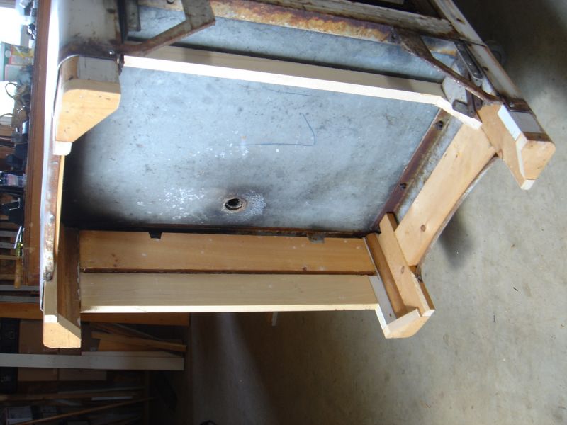

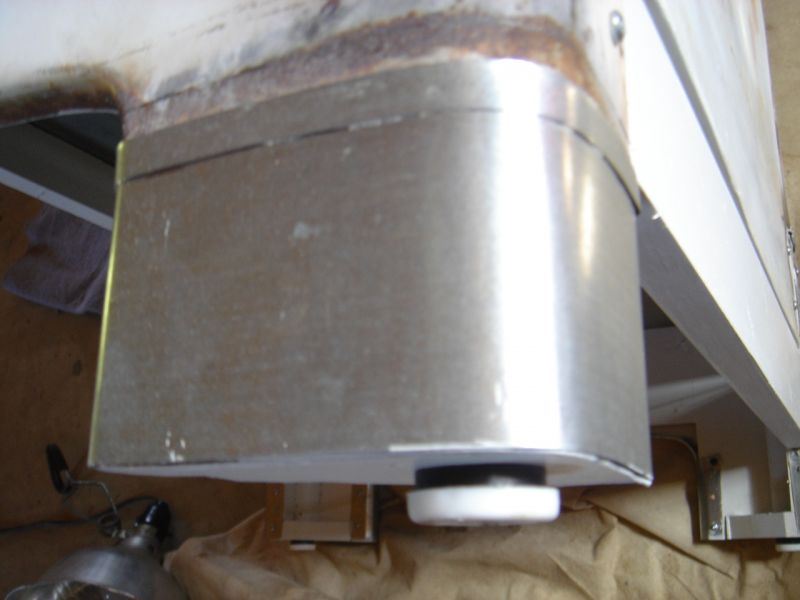

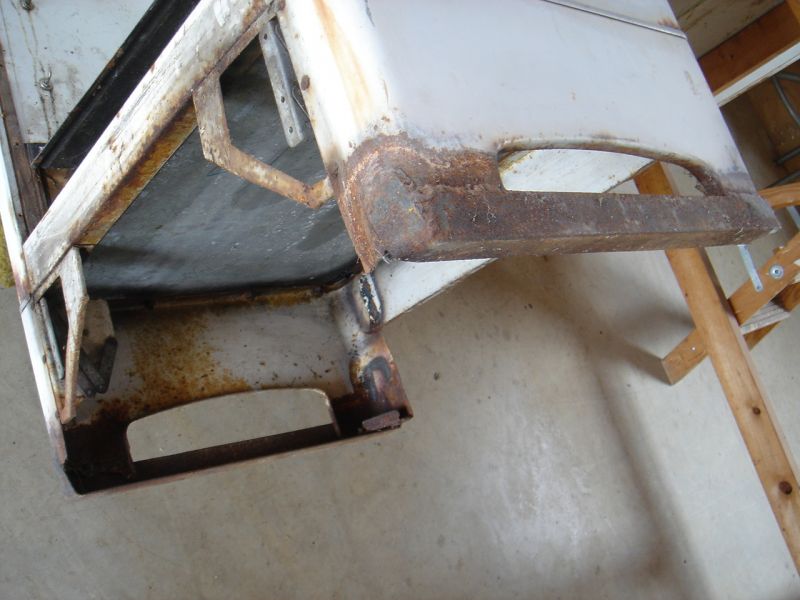

I love these pre power items and always have. Something about saving something that is mostly unwanted and restoring it to new usable condition has provided med with a lot of satisfaction. We have a local museum that I donated a large restored kerosene cooking range to, they would like to have a ice refrigerator for their historic rooms they plan to set up eventually. I have a couple I have redone also sitting next door in my moms basement. I may have to donate one of them, but for now this Coolerator is one I always wanted but could never find a restorable one around here. An amish fellow I knew had this one in a storage shed and I had seen it, but not quite all of it. After 15 years he decided to trade me for a little kerosene cook stove I had he wanted. When we pulled it out of the shed it became obvious the legs had been in some very damp locations for along time. I almost threw it away, but liking a challenge I decided to go ahead and try to restore it. I am glad I did now. Legs with welded bar for support. Had to cut them off just below the curve in the body.
|  Wood lower structure replacing bad legs.
|  New metal skin over shimmed wood to level it out with top skin.
|  Showing the condition of the water pan removal door before rebuilding them with metal and body putty
