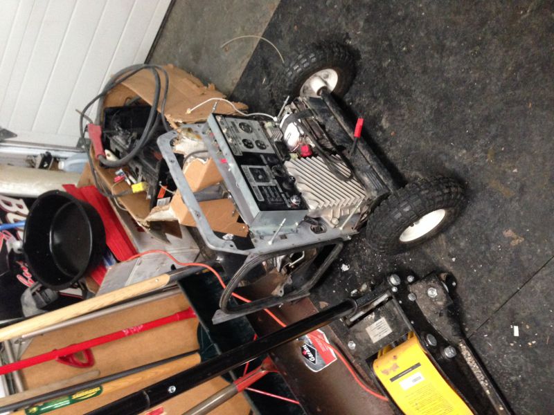

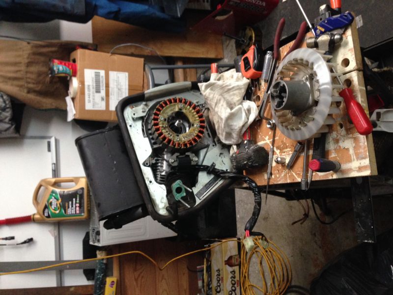

Must be the season. I went our cabin on the weekend and when I went to start the trusty Honda EU3000is ...no go. I noticed while cranking that the low oil light was flickering so checked the oil and low and behold there was none! I had just changed the oil not long before so I knew something was not good. Filled it up and away it went running just fine. I only used it briefly then shut it off. Looking underneath I could see the oil dripping out. I took it home with me and tore it down and found the crank seal between the engine and the generator head had blown out. I am just in the process of re-assembling now. The interesting thing I discovered while looking around the internet is that I could buy a brand new complete motor from Honda for $239.00! I am not sure about the 2000I but for the 3000is this would be the ticket for anything more serious or on a motor with lots of hours.

Hamish: That price was for the proper motor for the EU300is. I was surprised as well. It is a bit different than an off the shelf gx200 apparently. Here is a link to the forum where I found the info. Pretty interesting. http://www.smokstak.com/forum/showthread.php?t=146258
Toyota: Yes the seal was only about $5.00 U.S. It was getting to it that was fun! It is all back together now and running perfect. The seal had totally blown out of the housing and was just floating on the crank between the housing and the generator head. I am thinking either the pcv valve in the valve cover stuck or maybe it just vibrated out. I have one of those big pneumatic tire kits on it and it does tend to vibrate more because of that.
