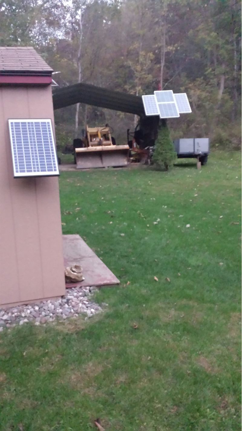

# Posted: 22 Feb 2016 10:07am
Might be another way , just sayen
just sayen
just sayen
