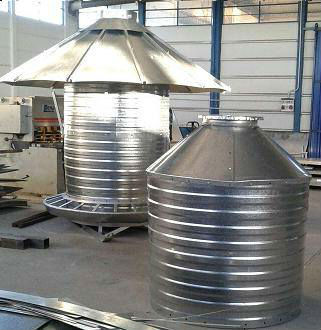

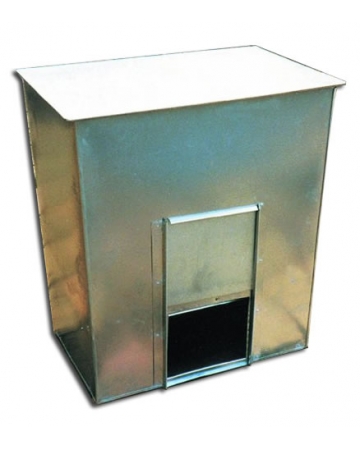

 Julie
 I'm not sure if your door would work in this application(pellets). You might not get it to close properly. All of our silos had a guillotine type door. If you are going to go that route check out some agricultural web sites for grain feeders/ storage as they might have something already designed to suite your needs. We had several small chicken feeders(silos/hoppers) attached to our buildings that had manual augers to feed the birds. I was just a kid so I have no idea how much they held.
 I think they make an add on hopper for the wiseway?
 |  Something like this small one.
 |  pellet hopper
 |  coal

| mossberg fan Member
 | # Posted: 26 Feb 2016 09:21am Reply
 i know here on the east coast, the coal suppliers sell coal by the ton in a big wooden box with a guillotine door on the  front, then they sell the empty coal boxes when they are done. alot of people use them for doghouses and such. any coal suppliers near your camp?

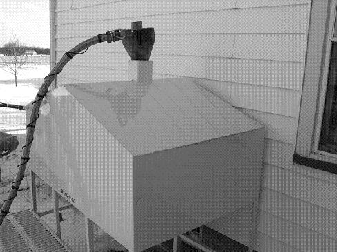

| Julie2Oregon Member
 | # Posted: 26 Feb 2016 05:03pm Reply
 Quoting: MtnDon Another option to alleviate CO concerns is to store pellets in a silo (inaccessible to people entering it) outside of the occupied building, with an auger feed system into the pellet appliance hopper and a CO detector near thehopper.
 Yeah, that's pretty much what I had in mind, except I'd have a small access door inside so I could scoop out some pellets to add to the wood stove. I'm going to have a small utility room in the cabin and the outside pellet bin/silo could be on the other side of that. This way, the pellets would be away from the pellet stove and away from the living areas of the cabin.
 It would be magic to have the pellets feeding directly into the hopper from the outside bin. But I wonder if that might not potentially clog up the feeder? I've read that folks recommend inspecting the pellets for oddballs and sifting for dust that occurs in shipment before putting them in the hopper because that helps keep the pellet stove burn better, keep from building up ash or creosote, etc.

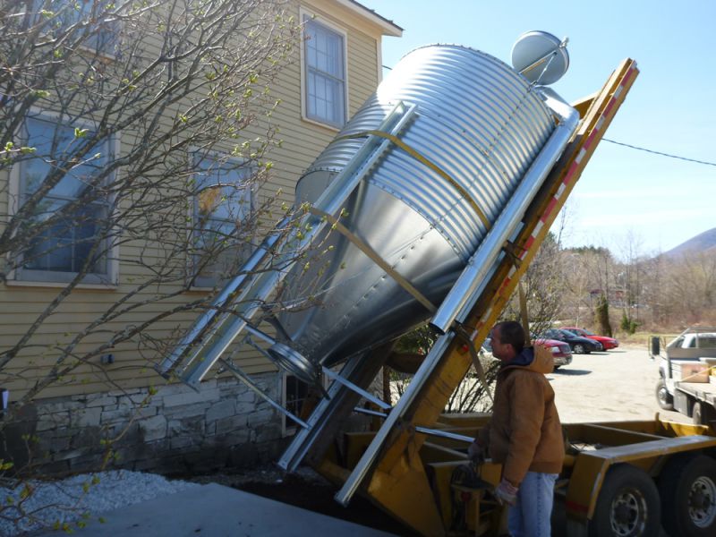

| Jebediah Member
 | # Posted: 26 Feb 2016 09:00pm Reply
 Julie
 This silo looks like it can hold at least a pallet load.
| Julie2Oregon Member
 | # Posted: 26 Feb 2016 11:25pm Reply
 Jebediah
 Holy crap, and launch missiles, too! LOL
