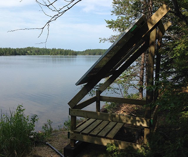

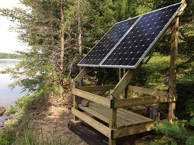

 100 foot distance to panels is not a complete failure. If you run your panels in series and use a MPPT charge controller you should be fine. I used 10 gauge wire to run 90+ feet with two 260 watt panels in series for ~ 70 volts. the voltage loss was minimal and works great. I needed the distance to get to the lakeshore to get a clear shot to the south due to too many trees as well.

 Distance is conquerable, though it may mean spending more money. An MPPT charge controller is needed, using a couple or more, "24 volt" PV panels in series.  MPPT can reduce the needed wire gauge. We have a run of 325 feet.

 There are voltage loss calculators on line. Just enter the voltage that your panels in series will deliver, wire gauge and distance and it will give you the estimated loss. Try to Aim for a maximum ~2% loss for efficiency.
 But really all your dealing with is efficiency of getting maximum power to your charge controller so a bit larger loss may be an acceptable variance given the cost of wire and other factors.  I used 10 gauge weather proof burial wire for the 70 volts max generated from my panels to go around 90 feet and I think it was estimated about a 2% loss.
 In any event it works really good and allowed for all components to reside in a power shed and then wired the ac and dc circuits into the cabin. When monitoring the trimetric it appears that very little loss was realized as the panels appear extremely efficient.
