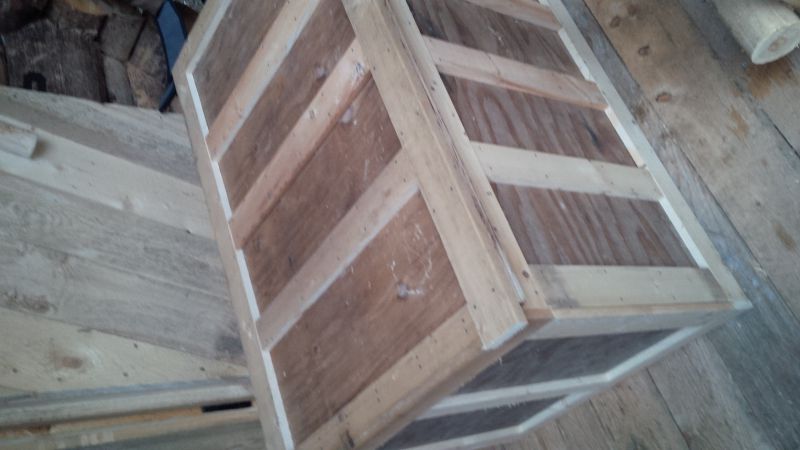

 This past summer I had some left over 1 1/2" thick rigid foam insulation lying around I was trying to decide what to do with. I also had some plywood lying around. So I decided to build a box big enough to fit my Coleman 5 day cooler in. I lined the plywood with the insulation, caulked all the seams and put weather stripping around the lid. My cooler fits perfectly inside the box that I painted white.  I found that even during the hottest times this summer, I easily got ten days out of my ice.  I was very impressed with how well this worker and was a great use of materials I had laying around!

 | # Posted: 7 Mar 2016 01:24am Reply
 Quoting: skootamattaschmidty This past summer I had some left over 1 1/2" thick rigid foam insulation lying around I was trying to decide what to do with. I also had some plywood lying around. So I decided to build a box big enough to fit my Coleman 5 day cooler in. I lined the plywood with the insulation, caulked all the seams and put weather stripping around the lid. My cooler fits perfectly inside the box that I painted white.  I found that even during the hottest times this summer, I easily got ten days out of my ice.  I was very impressed with how well this worker and was a great use of materials I had laying around!
 That's awesome!
  Being a chick, I'd just stencil some daisies on the box and proclaim it perfect, lol! What size of cooler did you use?

 My cooler is approximately 28"x14"x14" deep, so a decent sized one.  I tried finding pictures of the box but only found the one I have attached.  I painted the entire thing white to deflect the sun.  The lid is hinged and I have chains to hold it open.  My cooler fits neatly inside, I can open the lid to the box and then open my cooler.  Like I said it works really well and saved me a lot of ice last year.  The best part was I made it all with stuff I had lying a round and was trying what to do to get rid of it.

 | # Posted: 7 Mar 2016 09:30am Reply
 Sorry it's sideways, kind of looks more like a coffin that way..
