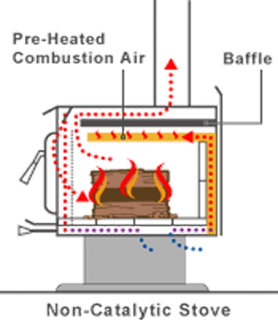

EPA certified wood stoves use either a catalytic converter or a secondary combustion system to burn the gases given off by the wood as well as the wood itself. That makes the stove more efficient and cleaner; lower emissions. Some states (WA is one) may have more stringent rules. A non-certified or EPA exempt stove may be illegal to install in many places.

A non catalytic wood stove usually has firebricks. Mine has them in the sides, the rear and above the fire. The ones above the fire also act as a baffle to direct the burning gases and smoke towards the front of the stove before they then are directed to the rear and out the chimney. There are also perforated stainless steel tubes in that upper area that introduce warmed air to aid in burning the gases. The sides, bottom, top and other parts are cast iron and fitted with gaskets where they interface. That makes for better air tightness. This stove uses a 6 inch pipe. That's two inches smaller than my old non EPA approved stove. I think that smaller pipes are common with newer EPA approved stoves as they are more efficient.

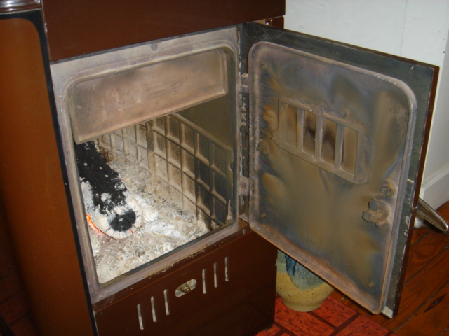

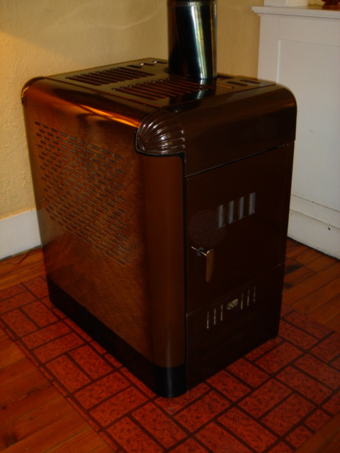

This is a subject I have very mixed thoughts about. Having grown up using many older stoves and distinctly recalling there ability to put out lots of heat when needed, my experience buying two very expensive EPA type models was less than happy. I also know from experience that a automatic type heater where the air intake is controlled from a damper affair is a creosote producer and responsible for much of the issues with wood stoves previously. I used to think that was a great idea, long burn, light one fire a winter, ect.. All good selling points. But once your chimney clogs up with creosote in a few weeks time and cleaning the chimney is necessary numerous times during the winter, you begin to see you have a problem. Currently I am using a wonderful late 40's manual draft circulator made by Oakland foundry in Belleville Il. It was evidently purchased by a family just before they got central heat and put the heater up in the second floor of the farm home. It looks like new, and works wonderfully. Lots of heat, long burn and best of all, almost no smoke or creosote in the chimney. To the contrary, the new heaters had tiny fireboxes, were so insulated to reach high burn temperatures that very little of the actual heat ended up in the house. I can get great warmth from my old one in a matter of minutes where the new model took hours and many days never heated the house well. I sold both of them. I know that the admires and supporters of EPA stoves will usually complain about my old heater, but it does what it should with way less problems and for a fraction of the price. The biggest problem is to find one in very good condition so that you can be sure that safety is at a maximum. I also make sure that every possible clearance and operation is done with care. I wouldn't trade my Oakland for all the new Morso's or Jotuls they make.
Larry Oakland Vintage Manual heater.
|  Holds nice large wood and easy to load.

Larry, I have that exact same Oakland stove at my home. I got it from my grandmother after she passed away a year ago. I'm finally getting around to setting it up, and now I'm having to play ring-around-the-rosey with the St.Louis county Public Works department in order to get it permitted. One of the things that they require is a copy of the owner's manual for the stove. My grandma didn't have any paperwork with hers. When I saw your picture, I couldn't believe it. Do you happen to have, or know where I might find, any sort of manual for this sort of stove? I've been having a tough time tracking down the information because it appears that the Oakland Foundry Co. went bankrupt sometime in the 1970's. Any help you could give would be greatly appreciated. Thanks. - Mike Lorenz crz53@yahoo.com
