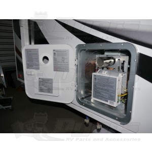

The Eccotemp needs one 3" vent hole. I think the tagaki needs one 4" hole. And can be installed through an insulated wall.
According to the install manual for the Girard "The Water Heater cut out opening is 13" X 13". "
I don't see where that Girard says it can be installed indoors. It specifies instead • All combustion air must be supplied from the outside of the RV, and all products of combustion must be vented to the outside of the RV. And further states • Install the water heater on an exterior wall, with access door opening to the outdoors.
It also says it cannot be vented other than as is. So no vent lines.
This means the Girard sits, in a box, uninsulated against the cold, on the outside wall of your home. That freeze proof heater will be running pretty steady come winter.
And the Ecco or Tagaki would be inside. Behind an insulated wall. Way easier for them to stay unfrozen.
I'm sorry, to me, this does not look like a suitable product for your needs.

The access door (and vent) is on the outside, flush against the exterior wall. The unit itself and the connections are on the inside. The wall insulation will help, of course. At least, that's how I saw it being installed on YouTube.

creeky This is a good pic of the unit and the pipe/vent to the outside.
I'm actually more perplexed by the placement of my propane gas lines/tanks for use by the water heater and the range. I want to connect two together via copper pipe and protect them and the pipe somehow from the elements, while also providing some ventilation around them. I'll need to check setback distances on that, plus make sure the water heater and range are on the same wall, I guess?
