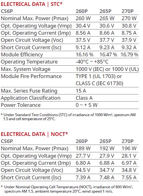

# Posted: 28 Apr 2016 08:18am - Edited by: Steve_S
Grid Tie Panels are the higher wattage, higher voltage panels. The typical 12 volt panels max out @ 100 watts and are very pricey at that wattage level (between $1.25 - $2.00 per Watt). Like the Grape Solar 100W @ HomeDepot.COM is $141.00 USD, Here's a good (limited)price comparison chart www.solar-electric.com solarpanels
Best bang for buck is using the Grid Tie panels which can now go as high as 500 watts a panel(just coming out), the most common on the market being between 250-310 watts each panel averaging at 80 cents per watt or lower.
My own system uses Canadian Solar 260W 60C Poly PV module, CS6P-260P, which cost me $ 214.00 CAD, ea. (in April 2015) Attached is the electrical specs for my panels, hopefully that helps.
With MPPT you can over panel somewhat to keep your production up in lower light conditions and the controller will handle that and step it down for charging your batteries.
