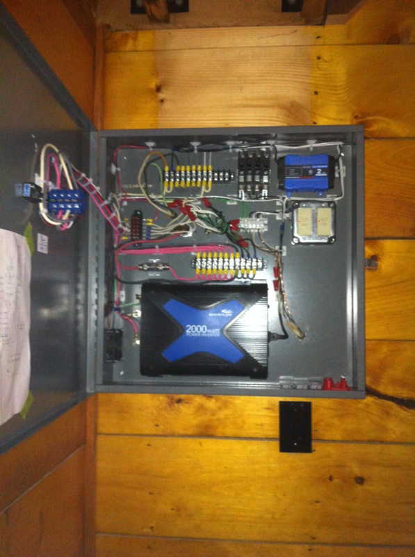

# Posted: 22 May 2016 10:19pm
The panel has a Whistler inverter, couple of GFIs, breakers and fuses.
When yhe panel is closed there are 2 switches on it- an on/ off rocker and a 3 way position switch- top center is off, left is 12v and right is generator
The panel is connected to 4 deep cycle batteries.
In the cabin wherever there is a 110 outlet there is a 12 volt cig lighter socket as well.
The panel also has a digital gauge that shows voltage for 12v system.
That's really about all I know. There is a problem in the system that draws down the voltage - while taking a shower the pump stopped for an example.
The day I closed the electrician did come over- he said it could be 1 bad battery, or a couple or all of them.
I guess I have to bite the bullet and pay him to figure it out.
If anyone can think of any questions to ask please let me know
Bigred292
# Posted: 22 May 2016 10:25pm
I believe the blue thingy in the upper right of my panel is a charge controller.
There is an indicator light that lights when system is charging from generator.

But the charge controller is not in the circuit you have the panel running through . Have your electrician hook it in the correct circuit the next time your there , in the meantime it will help charge your batteries, not to worry.

yes it will charge .... did you turn off the inverter when you left . [its the larger blue box in the middle of the pic .] it will use all the power that panel makes on idle .

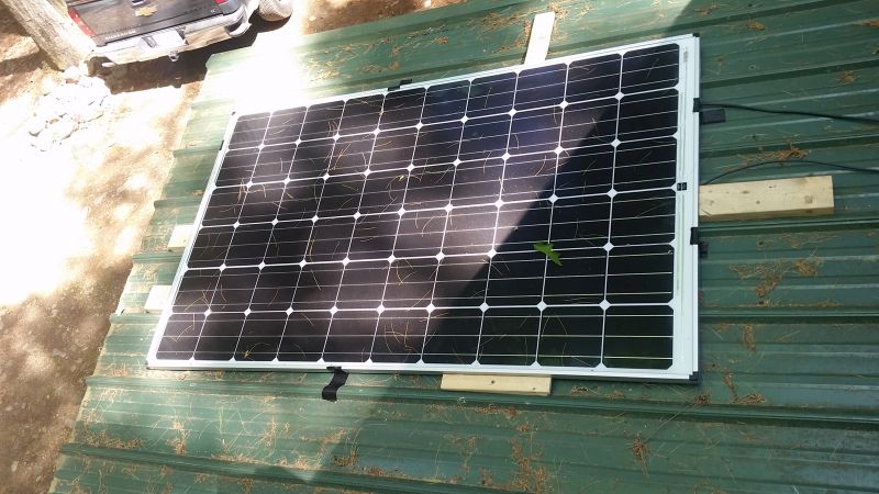

# Posted: 1 Jun 2016 10:28pm
Just an update on electric system - went to the cabin yesterday at met electrician. I wound up getting the parts through him. I got a 285 watt panel, 100 ft of wire with connections and a charger controller.
I put panel on porch roof. I didn't permanently mount it yet, just in case I find a better spot. Ran wires from solar panel to elec panel.
We did a load test on all 4 batteries (installed 4/15)
2 of them completely dead.
2 of them close to death.
He recommended we try 2 batteries - he felt 4 was too many.
If more are needed they can be added easily. Got 2 today and electrician camel back today and hooked everything up.
Everything looked good. Unfortunately had to head home shortly after work was done so couldn't enjoy it tonight.
$375 solar parts, $180 batteries, $200 labor
Hopefully this will do it.
One question - about how many hours of sun are needed to maintain charge? I know the more the better but what is a reasonable amount?
Where I have it now is perfect because it really can't be seen at all. I'm worried about it being stolen. I do worry about vandalism and theft
