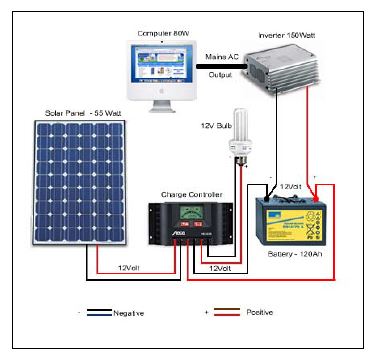

Here is a crude diagram taken from Solar Secrets.
crude diag of solar hookup
Rickkrus
# Posted: 24 May 2016 01:19pm
Thanks ugotDave but the diagram shows one battery. My question is how to hook up two batteries>

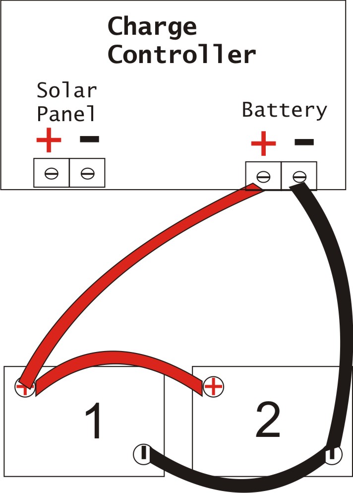

Rickkrus
# Posted: 24 May 2016 09:24pm
on the same battery or pos on one and neg on the other?
ugotDave
# Posted: 24 May 2016 10:24pm
Sorry brother, I missed the two battery part...
Here is how I connect my parallel batteries. My drawing is crude and not complete but it will allow for visual aid.
