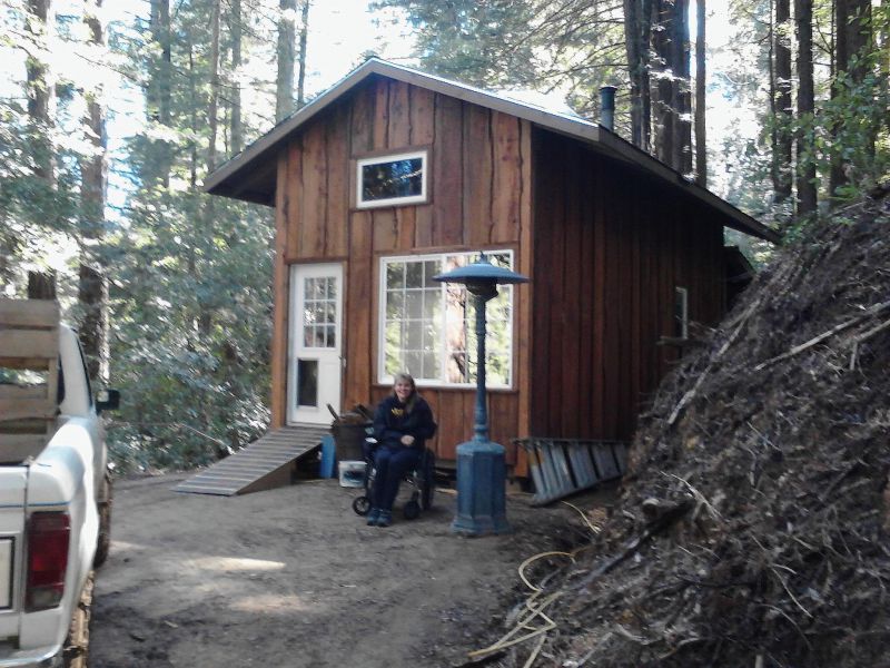

# Posted: 4 Jun 2016 11:15pm
Can't do that in my case (that's an old cabin photo, it has a deck now and stuff, but she remains a real trooper). No snow.
