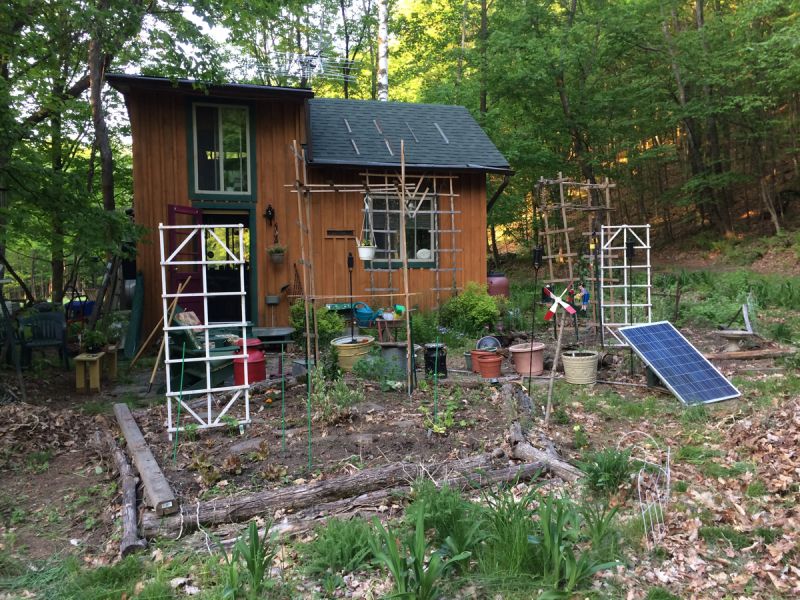

 My 12 x 20 cabin is four years old, and I'm upgrading! I've run and ad hoc 12v system at the cabin to supplement my solar system (3 x 100 w panels + batts + inverter) since day one, but now I'm adding a 12v system at the cabin (putting panels on the roof).
 I've been searching for indoor lighting fixtures with next to zero luck (found a few on campers world). Anybody got a source?
 Latest piccy of my sweet cabin attached.
 |  Just arrived, spring 2016.

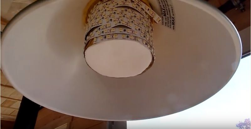

 I made my own 12 volt lights from bulk LEDs. You can buy LEDs on a 5m roll on eBay for about $6. These strips can be cut and installed into standard light fixtures with some rewiring.
 I demo this idea in this video
 https://www.youtube.com/watch?v=ftQ1fsBOirc
