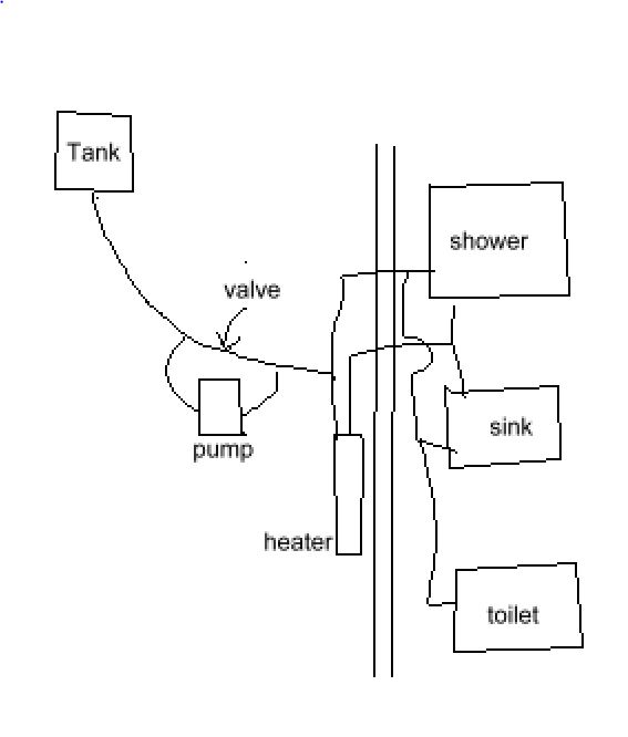

Finally getting around to hooking up my L5 heater and Flojet pump. My water tank is above my cabin and I have been using gravity feed so far, and was hoping to continue doing so some of the time but I tried to blow through the Floject and can't. Does this mean when I install the Flojet it has to have power to it all the time, otherwise no water?

# Posted: 8 Jun 2016 10:39pm
Thanks Hammish. Do you mean a bypass line around the pump, with a valve in it, so when the valve is open the water bypasses the pump? That would work but my pump will be outside (since the L5 is and the pump has to be prior to it), so I would have to go outside to turn the valve. Which is OK I guess.

# Posted: 9 Jun 2016 12:09pm
I don't see how. This is how I have it laid out, and where I think the bypass and valve need to be. Is there another way?

# Posted: 9 Jun 2016 02:31pm
Everything on the pump when in use.
So with a check valve the water runs through the bypass, and when the pump is powered up and a faucet is opened, the pressure of the pump closes the check valve?

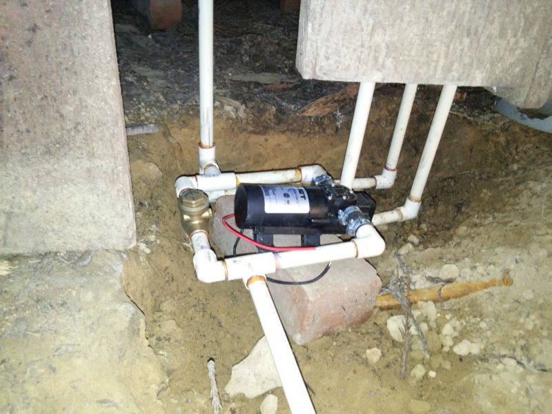

# Posted: 19 Jun 2016 07:09pm
Success! The check valve works perfectly, gravity feed when pump off. I jumpered a battery to the pump, shuts check valve and works great!

# Posted: 27 Jul 2016 09:07pm
My water system has been working great, I just have one concern; the pump comes on for a second every couple of minutes. For the life of me I cannot find a leak. I have shut off the toilet valve, the sink valves, the water heater (L5) input valve..
I'm starting to sheetrock the bathroom so want to make sure nothing is wrong first, though the pipes and studs are all bone dry.
Thought it might be the gate valve leaking, which would pump water back towards the tank, but I have a valve on the input pipe and shutting that off doesn't help.
Just wondering what troubleshooting I might do other than looking for leaks.
