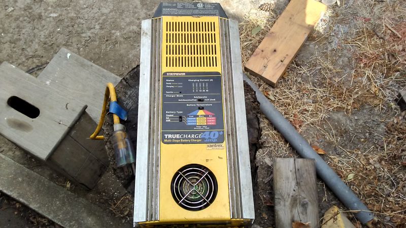

Waiting around for my Valence U27-12XP 138AH Lithium battery to show up in the mail. Meanwhile at the flea market today I picked up this battery charger for 10 bucks because it looked more hi-falootin than anything I have. Kinda hoping I can charge the Valence with it but I know lithiums are supposed to have a special charger.
The bells and whistles are shown in the photo. It works, at least in fixed mode. The Valence batteries have some BMS circuitry built in, but apparently you need some external stuff too. Still reading up on that.
Lead batteries are simple, this is all very confusing.
The manual for the charger. Xantrex, anyone have one?
http://www.xantrex.com/documents/Discontinued-Products/TC20_40(445-0050-01-01_Rev-A). pdf
