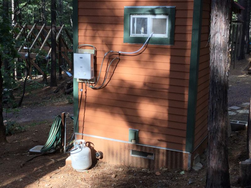

Recently I got an Eccotemp L5 portable water heater for the application you see below, but it didn't work for me because I have less than 20 lbs water pressure from my water tank. The Eccotemps all have that minimum requirement. I could start it up, but as soon as it produced hot water it would shut itself off. I guess they consider it a safety feature, but I'm not sure why. If the unit overheats from low flow, shut it off with a temperature switch, not a flow switch. I don't know.
So, did more research and found that the Marey 5L portable will operate at far lower water pressures- down to 5 lbs. So I got it, installed it as shown, and used it for several weeks recently with no major problems.

The unit was made in China, not sure but I think the Eccotemp is too. They look so similar I bet they came out of the same factory. Both units are so light they seem flimsy but seem to be solidly put together. The guts are all metal but the controls and shower heads are all plastic. I think I'll replace the shower head with a brass valve and shower head. The plastic handle they give you has a valve in it, but I just don't trust plastic valves of any kind. But both units are in the $125 range so what do you expect.
One odd thing is that when it's windy outside sometimes the thing will shut off in the middle of a shower. I turned it off and on again and it started right up every time. Maybe there is some automatic shutoff if flu venting doesn't occur correctly.
Both units are around 35000 btus. The Marey easily heats my cold tank water to shower temp at a decent rate of flow. If you have ice cold water you might have to reduce the flow rate a bit to get hot enough water.
I couldn't give the Eccotemp a good test cause it stopped working because of water pressure, but it seems to me the units are both pretty much the same except for the minimum pressure at which they will operate. I'm happy with the Marey, there's nothing better at a camp site than a hot shower after a sweaty day.

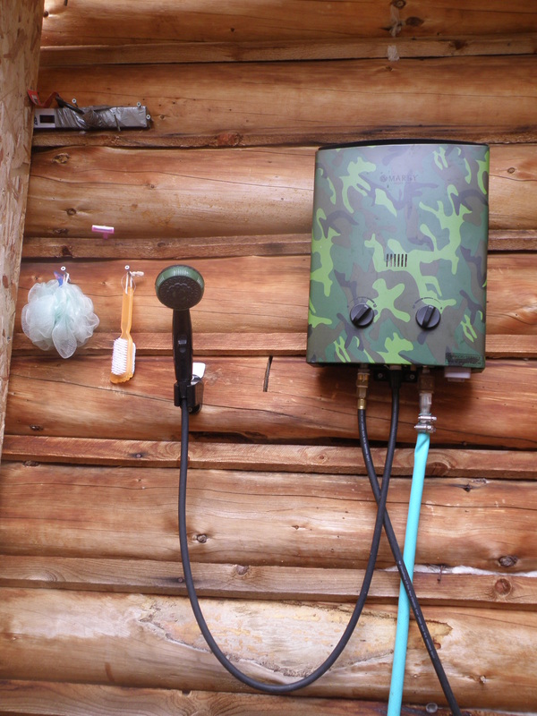

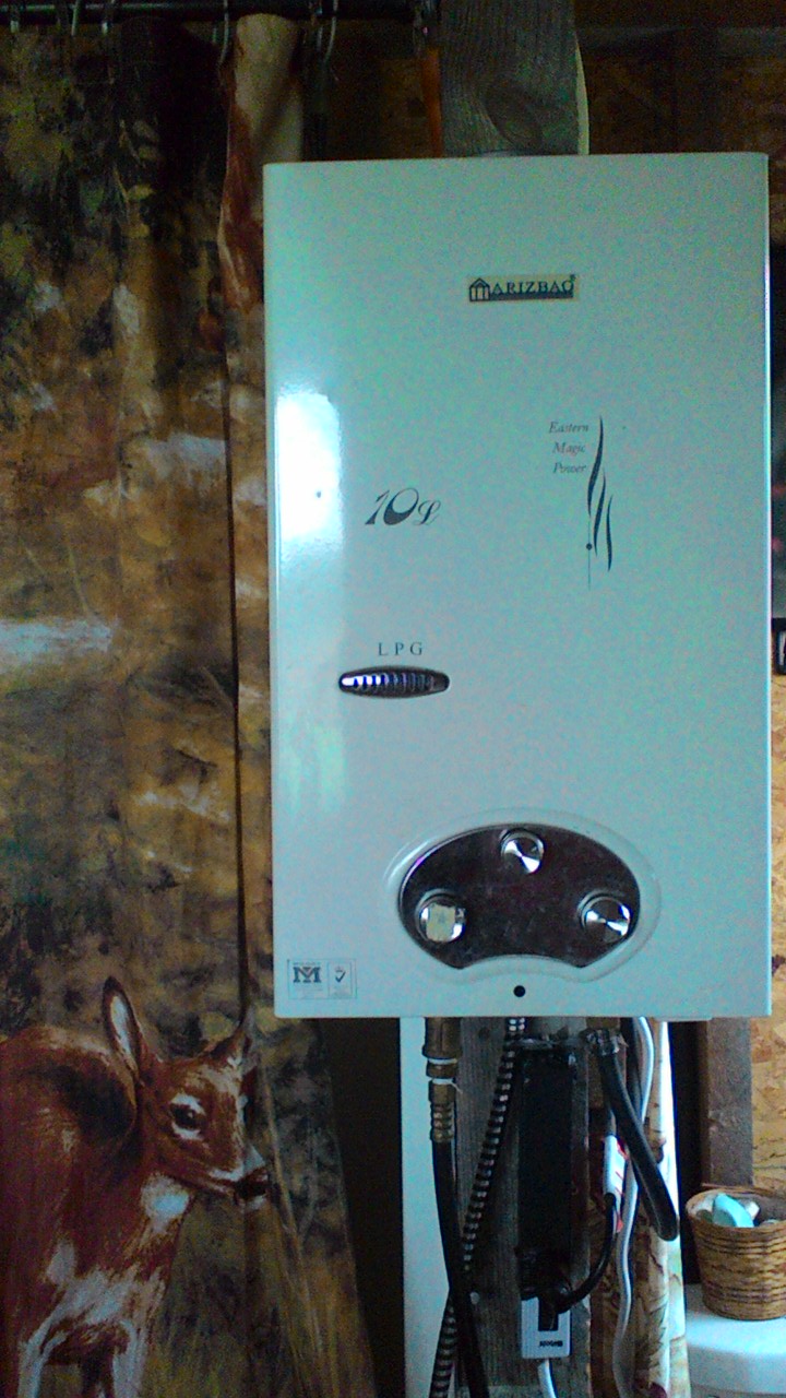

Thanks for the welcome We have had our main on-demand propane water heater in our homestead cabin since 2007 and it is an Arizbao. The outdoor shower one is a Marey we bought on ebay 3 years ago. We have hard water and they have done well, but we learned from our friend's experience to be sure to drain them if there is a possibility of freezing. The 1st attached pic is of the one in our homestead cabin that we have had since 2007...The 2nd is the Marey propane_water_heater.jpg
