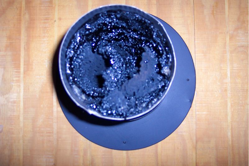

I purchased my ~8 year old cabin in the late summer, and decided to check the stove pipe prior to the first fire. I'm glad I did!
I'm not sure how they could get smoke to exhaust. It explains why the smoke detector batteries were removed.
The creosote was quite brittle and easy to remove. A mild thump on the pipe started an avalanche. There is a "T" with a removeable cap on the outside, and it all got cleaned out. Later I made a good hot fire, followed up by a "chimney sweep" log.
I'll be sure and inspect these pipes regularly.
Although the previous owner had pretty much hardwood only to burn, I think most of the wood consumed was somewhat rotten and did not burn hot enough to prevent this buildup. All the remaining firewood on the site is a bit soft/lightweight for oak and hickory. Future firewood cut will be stored off the ground and covered. The rotten stuff will be burned outdoors only.

Thanks for the info and picture, SE Ohio.
Does it really has that bright blue color or it's just the way in came out on the photo?
SE Ohio
# Posted: 6 Dec 2010 07:28am
I think it is just the camera/photo. It looked pretty darn black to me at the time!
