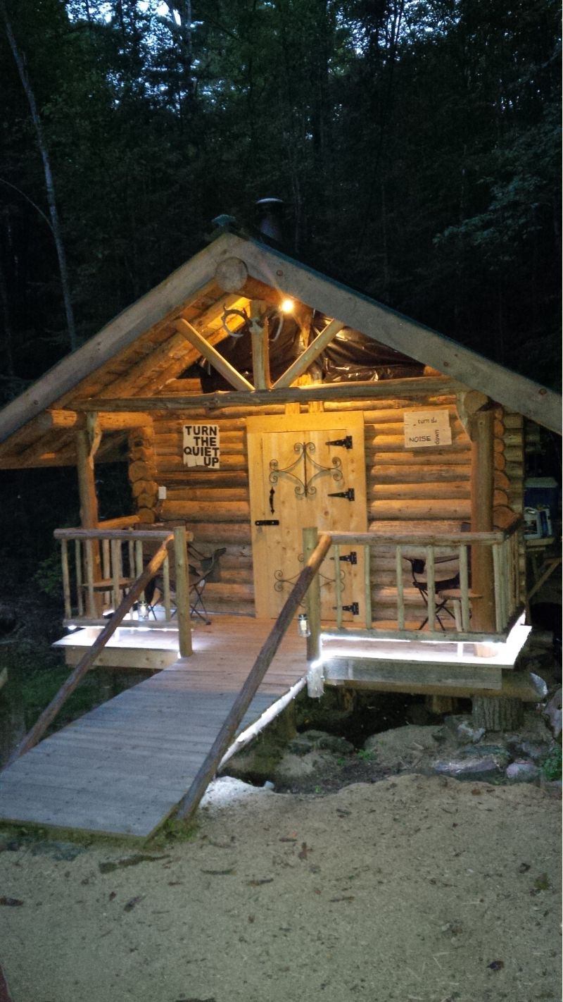

Uwould
# Posted: 26 Aug 2016 05:08pm
Wow, thanks! I would be willing to spend $200 for a good set-up. I looked at the cheap solar shed lights......i guess i would like something a little more substantial. I do want to stay with all 12 volt and led light with a sealed battery that i could keep inside. Thanks for all the suggestions. I will try and post a picture of my cabin.

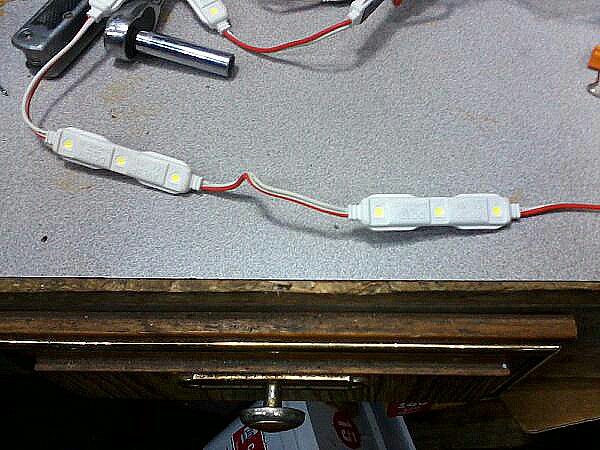

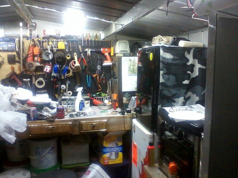

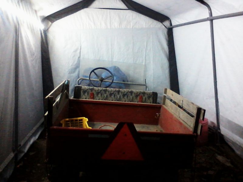

# Posted: 26 Aug 2016 09:59pm
Here are a few pics of my tool shed and tarp port. Also a pic of a couple of the led lights. All are powered from an old car battery, and it is recharged with a small solar panel from Harbor Freight. I got the LEDs from St.Louis lighting, but eBay has them also. It may be too bright for what you need but I believe there are dimmable ones available. Picture0826162034_1..jpg
