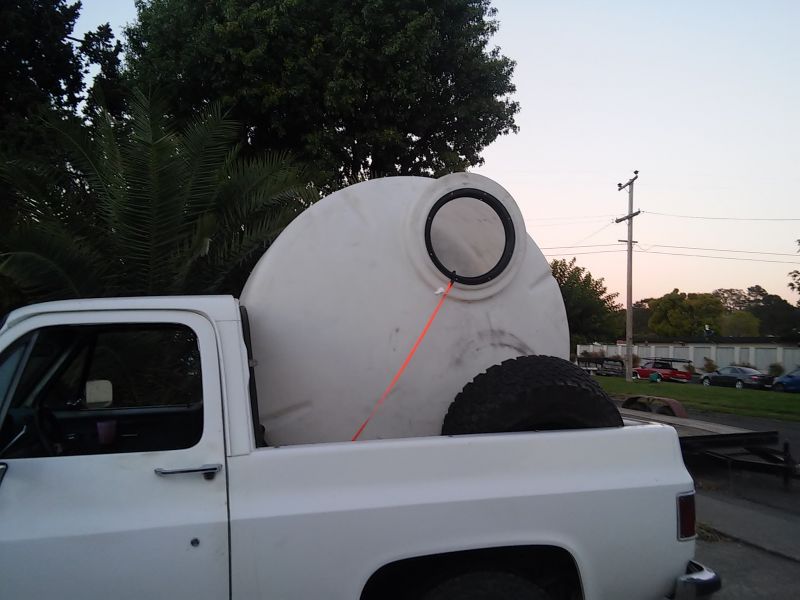

I was thinking how quickly my well empties itself, then my neighbor came over and said he has two tanks, one at his well and another up his hill at his house. Well, long story short, I picked up this 550 gallon tank today for 100 bucks. I'm thinking I can put it down the hill by the well, or move the 750 gallon tank down the hill and put the 550 at the cabin. One difference, the 750 is solid green, this one you can (I guess) see the water level.

# Posted: 25 Sep 2016 11:21pm
White colored tanks are generally not intended for potable water use. That doesn't mean you can't use it for such, but two concerns-
Potable water tanks are dark green or black to blank out sunlight to inhibit growth of algae in the water. If you use the tank, you should at least keep it in shade, total darkness preferably.
White tanks are often used for agricultural purposes, fertilizers, pesticides and all that good stuff. You don't want to drink water that comes from it. Polyethylene is porous to a degree and will absorb and then let off chemicals.
Hope I didn't rain on your party. $100 for a 500 gallon tank is cheap.
# Posted: 26 Sep 2016 10:47am
Ew, that's not good. This tank is new so no previous chemicals to worry about. And shade is not a problem at my place.
Live and learn..thanks!
