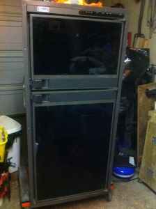

My spouse wanted a RV fridge to flush mount into the wall. We saw a used Servel 620 RV fridge for $650 on Craigslist and wondered if it was a good buy. It can be used with regular house power or propane. I have no idea how old it is.
Does anyone have experience with this type/make of fridge?
RV fridge
RV fridge
# Posted: 10 Dec 2010 10:23am - Edited by: MtnDon
First make sure it works. You want to see frozen stuff frozen in the freezer part, preferably ice on the wall somewhere so you know they just didn't stuff it full of already frozen stuff. Don't ask why I say so. If it is in excellent condition that is probably a reasonable price. Those are expensive new. No idea how old that is but I can't remember seeing a new Servel RV fridge in a long time. Today they only import a home/cabin free standing style propane model. Good thing is most parts are available.
This type of fridge works from heat. The electrical portion uses a small resistance heater coil. They tend to use more electricity than a compressor type. The AC is handy with an RV when you are trying to stretch out your propane when staying in campgrounds you're paying fees for anyhow.
The back side must be well vented to the outside with intake near the bottom and an upper exhaust vent. They work well when setup when correct spacing and air channeling for the coils in the rear. They need to vent the exhaust from the propane flame as well as get rid of the heat from the inside of the box. Because of the CO danger it's best to vent to the outside.
If it is large enough to do the job for you it may be a good one.
Note that this type of fridge does not cool down as quickly as a standard home fridge. We have this type in our RV and have a Servel 400 home/cabin propane fridge in the cabin. See it at thenaturalhome.com to compare and price.
