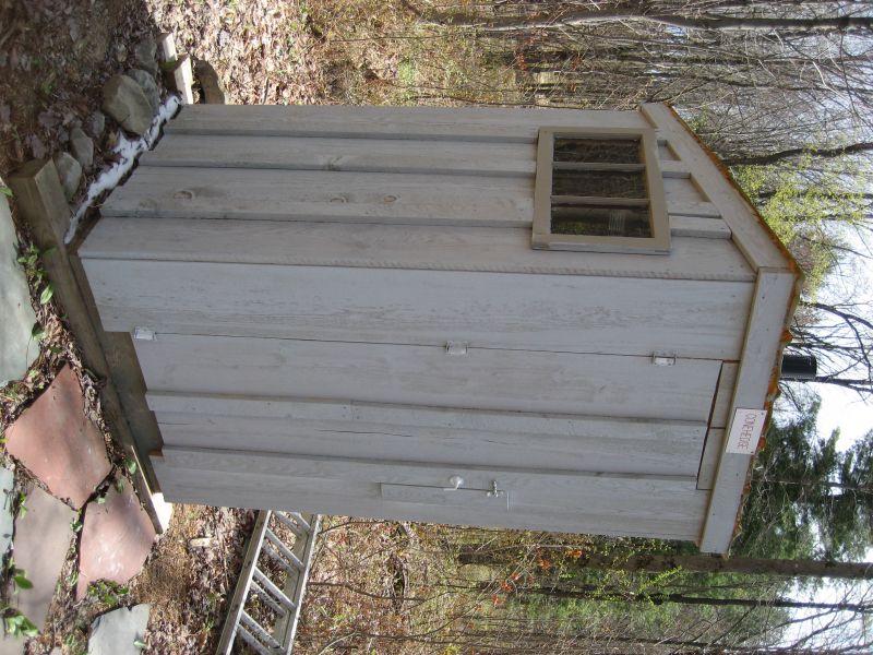

I think if you had run your vent pipe straight up, it would have vented better. I built a simular size outhouse a few years ago, but vented it up on the inside from the toilet seat platform. You need to have a small vent on the outside down low to add air to the poopp hole. I have some busy weekends at the cabin with no odor.
outhouse
outhouse

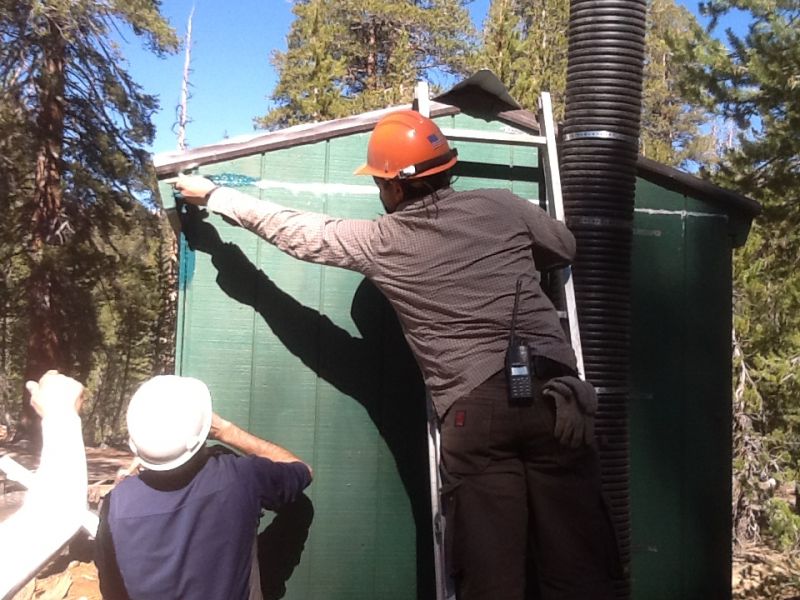

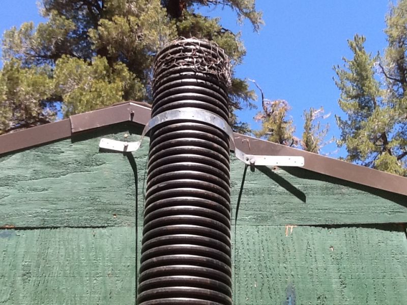

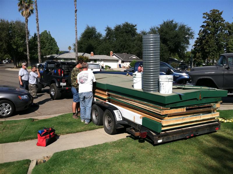

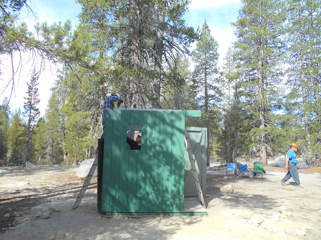

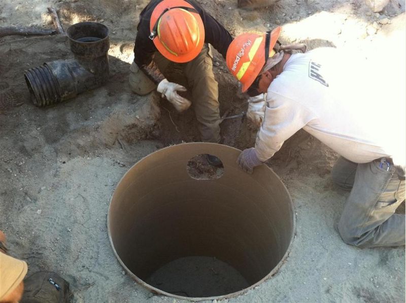

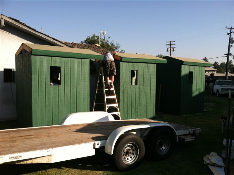

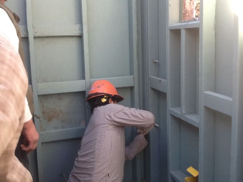

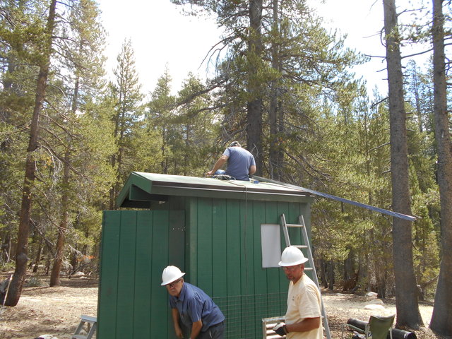

I've helped install/move many toilets on local 4wd trails, including prefabbing four in my back yard.
Big Ed

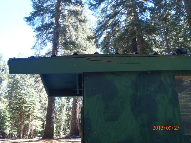

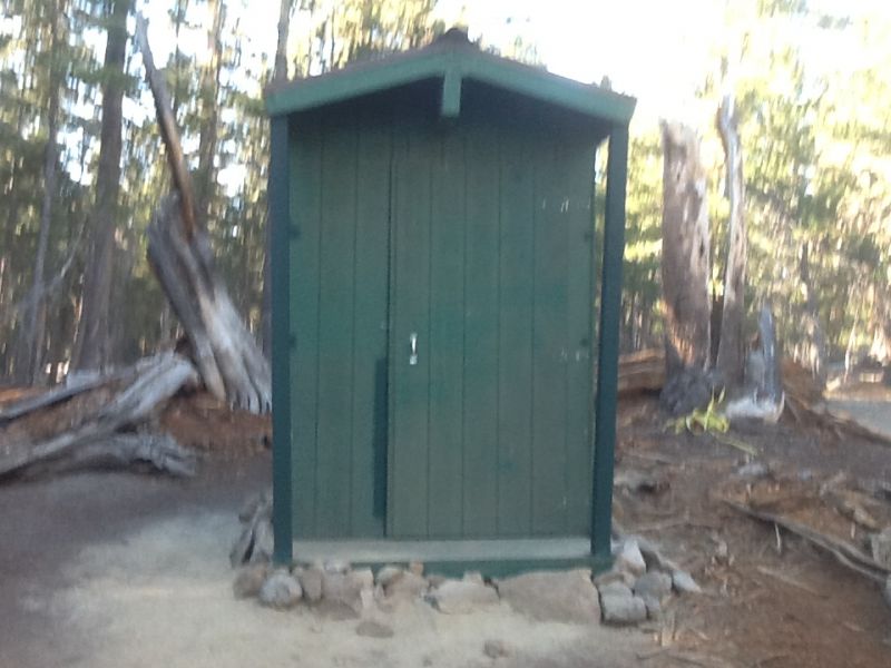

# Posted: 8 Jan 2017 09:56pm
The snow load on the unsupported front section was breaking fascia boards, posts were added to prevent that.

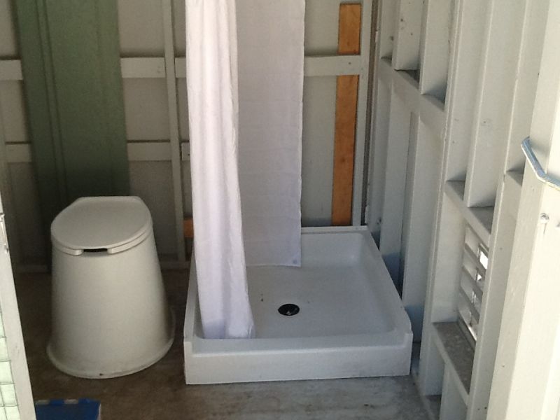

I also helped the horsemen install one in the backcountry. They put a shower in theirs, and use shower bags. I have the plans for these, but the battery is no good on the laptop they're on right now. We use a much bigger vent pipe, and don't need a fan.

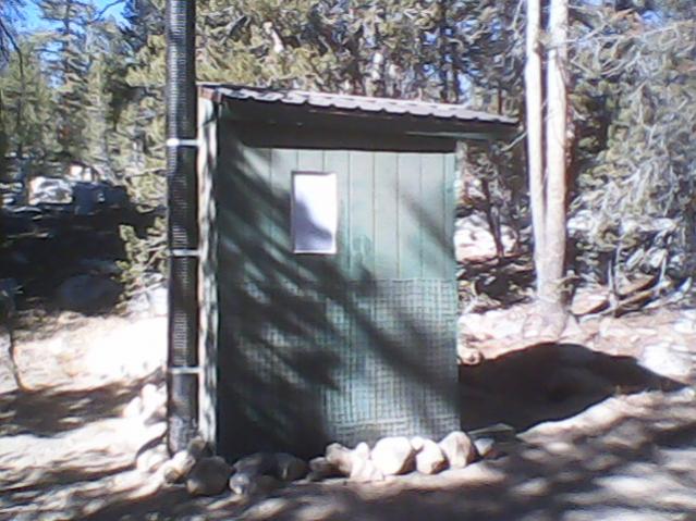

# Posted: 8 Jan 2017 10:11pm
Vent pipe.

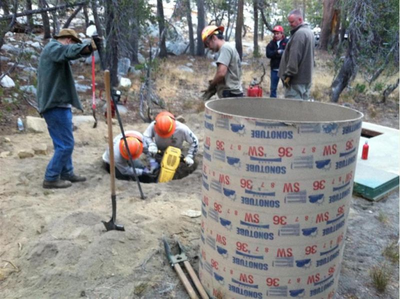

Big Ed
# Posted: 8 Jan 2017 11:53pm
More of the vent pipe. Also that's a sonotube in the ground, they cut a hole in it for the vent.

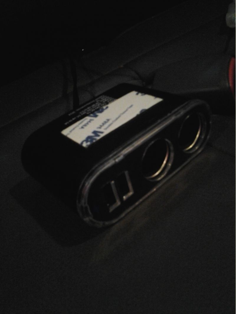

Some 12 volt solar panels max out about 22-23 volts open circuit, no load (nothing connected, panel wires separated, voltmeter connected). Some of the cheap auto accessory "cigarette lighter" extension cords (Walmart, etc) take 12-24 volts input and output 12 volts and have a couple of 5v USB outlets. Just cut off the "cigarette lighter" type plug and connect to solar panel leads, + to +, - to -. No battery required.
Might be perfect for your setup with a 12 volt fan, just don't forget and leave your phone charging in the outhouse...
Edit- Added (poor) photo. There are 12 volt automotive fans that plug into a cigarette lighter outlet, easy connection.
Potential 24 to 12 volt converter
