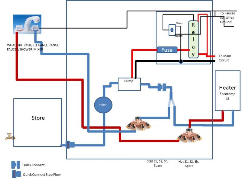

Alternative: I have the L5 (same basic thing just slightly smaller) with a flojet 12V pump. The pump has a built in pressure switch so, if you use a small tank, it is the pump that will come on when the pressure in the tank drops. In fact, i do not use a tank at all (essentially the plumbing acts as the "tank". Open a tap, pressure drops and pump comes on. I actually use mine slightly differently - My faucets (Whale Brand) all have micro switches in them wired up to a relay near the pump. Open a faucet and the relay closes powering the pump. I did not bypass the pump's built in pressure switch so if you turn a faucet only enough to power the relay/pump but not enough to actually allow water out of the tap, you will hear the pump come on and then cut out as the plumbing line pressure builds up to the pump cut out setting. Although highly unlikely to happen - prevents one of the kids not closing a faucet all the way. Also, should a line leak, as the switches are not on, the pump will not run.
I think the decision on whether to use a pressure tank really depends on how much you expect to use the system and how many concurrent users you expect. Despite the long explanation, my system is very simple but is not designed to have kitchen and shower going at the same time without fluctuations in temperature and flow.

Rebel300r - based on your second post (while I was typing mine), it sounds a bit like your system might end up being similar to mine. Here is a simplified diagram of what I did. Note the two "manifolds", one for cold and one for hot. Diagram shows only one line out from both but four connections each. My current system has a shower and two sinks (so 3 or the four used).
Water System
Water System

Raz, do you remember what flojet you used? I see that EccoTemp has one that they sell in a package with the L10. I am going to buy that one methinks. I appreciate the diagram. I think darz idea of a switch in addition to the pressure switch in the flojet is a good one. Thanks!
