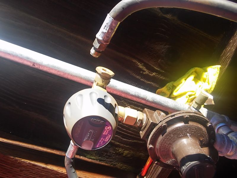

The Chief now wants to tie in the extra two tanks he bought, such that two tanks draw at the same time, then when the regulator switches over it draws off the other two. Bad idea? So I would need a pair of hoses, each able to fit a tank on one end with a T on the other end that fits a tank and the male fitting on the existing hose. Off the shelf item or something I'd have to make up?
Edit: thinking this through a little more I would tee them at the regulator with standard pipe fittings.
# Posted: 11 Jan 2017 09:48am
DIY, a tee on each side of the regulator with two hoses attached to each side.
I see this as a lousy idea. Now instead of the two tanks running dry because nobody bothers to check, all four will run dry. (the pessimist as to how people fail.....)

# Posted: 13 Jan 2017 06:14pm - Edited by: paulz
I pulled a hose off today to see what I need for a T. It is not pipe thread as I thought but flare. I tried to loosen the brass reducer off the changeover valve but it was very tight. Standard RH tread would it be?
