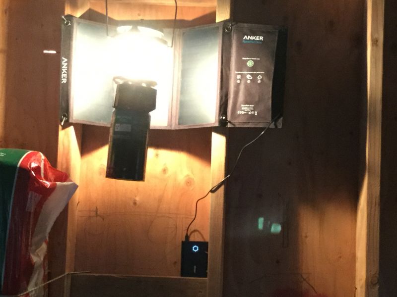

Ok, so maybe it was a stupid idea, but I tried it anyway.
Having a little 21 watt solar charger that I use in summer, and since I was going to be using the propane lanterns anyway, I thought I'd see if the lantern would charge the storage battery (which would then charge up the phone and tablet). But, alas, the best laid plans of mice and men, it failed miserably and didn't charge the battery one bit. Rats.

Solar panels use both spectrum (380-750 nm wavelength) and power in order to knock the panel electrons around to generate current. The sun's solar energy on a sunny day provides about 1,000 watts per square meter on the Earth’s surface. A light bulb produces between 40 and 100 watts. Compare the propane light to a light bulb to the sun. You probably won't get a sunburn from the propane light.
# Posted: 2 Feb 2017 08:47am
DaveBell- I'm sure you're right. The solar panel has a light that comes on when the panels are exposed to sunlight, showing that the panels are producing. This light came on with the propane lantern, but the battery showed no increase in charge after several hours. It may have been getting a trickle, but not enough to make a difference. Or there may not have been even enough current to overcome the resistance in the wiring and electronics in the panels and battery. For a time I put two lanterns at the panel, same result. Oh well.

Do you have a DMM or other meter that measures current? You could measure current produced by the light and then calculate how many hours of light needed to replenish the amp-hour rating of the battery(ies). You should measure some current if panel is working (voltage too).
That being said, you'll do better with the panel by a window. I'm assuming it isn't weatherproof? I manage to recharge a pair of 4 amp-Hour batteries between cabin visits using a measly 1.5 watt /12 volt panel sitting indoors up against a southern exposure window.
