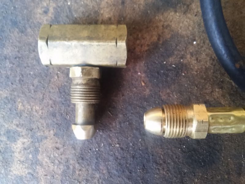

Can't get these to pass the soap test. I've lightly sanded them clean, no obvious boogers. Any tricks?

No, no teflon tape on this joint, I believe. The threads on these fittings are not tapered and not meant to seal, but the brass face is the sealing surface, if I'm not mistaken.
Are you putting both of those fittings at different times into the same tank? Is it the tank side that's bad, maybe?
Sometimes the fittings are bad right out of the box, too. The taper isn't right, etc. Many of them now use O-rings instead, easier/cheaper to make work, but don't last as long.

DO NOT USE ANY TYPE OF SEALING TAPE OR PASTE!!!!!
those fitting seal on a crush face not threads. use some fine scotch brite to clean them up. If they continue to leak on of them is bad

I've seen those type just not seal for no particular reason from time to time. Common on welding stuff. I guess they get crushed slightly out of round or something.
Nothing I have ever found will fix them, except buying new

Previous comments about NOT using tape or sealant on that type fitting are correct. Same for compression fittings, the threads are NOT the sealing surface. Sometimes some lubricant on the threads or shoulders of threaded fittings allow the fittings to move without squeaking and binding, but the threads, again, are NOT the sealing surface.

The manufacturer (Brasscraft) instructions on the water heater flex line I just used, came with instructions that stated to use no sealants of any kind on the flare. Where the flare fitting was assembled to the pipe threaded portion they indicated to use gas pipe teflon or a pipe dope sealant.
Brasscraft also stated that the use of food safe mineral oil may be used on the threads on compression fittings or flare fittings in order to facilitate tightening and possible future dismantling.

these joints are designed to seal on the mating face. no tape or dope should be used. over time it will allow gasses to escape. Talk to anyone in the flammable gas industry, anyone that works with oxygen, hydrogen and many other flammable gasses and they will tell you tape or dope is a BIG NO NO!
"I will continue to use dope on unions, as all plumbers do."
Don't know where you are inspecting but when I was building houses, if a plumber did this, the inspector would fail it.
I work assembling tubing and pipe for services rated up to 60,000 psi. We do under 15K in our sleep. Trust me, is it's leaking get a new fitting, a quality fitting. Propane sinks and collects when it leaks, nothing to mess with. Unless you want a bunch of match sticks after the explosion.

bldg has it right. Sealing the threads on this fitting isnt where the seal comes from, that just is used for the clamping force. I would say the OP has leaks on both fittings, the booger may be on the receiving end????

How are you proposing to use teflon tape on a POL fitting, where its threads are on a bushing which freely rotates around the stem? The stem head has to seal against the orifice bottom, not the threads. No tape should be used on the POL fittings!
Sanding the head is probably what is causing the leaks. Throw away this fitting, buy another one.
# Posted: 3 Feb 2017 12:41pm - Edited by: paulz
Sanding did not cause the leaks, if it didn't leak in the first place after several attempts I wouldn't have cleaned it up. And I'm not talking about holding them to a belt sander. A couple of twists by had with 300 grit just to take off the surface corrosion. But yes, time to buy a new fitting.

I occasionally find damage on the male domed sealing face of a propane regulator. This is usually caused by careless placement of the detached regulator while moving the old bottle out and the new bottle into position. If the regulator falls or swings down on its hose and strikes a hard object then a dent can be caused in the domed face. When a dent occurs a "crater" is formed with raised displaced material at its periphery. The same thing happens when using a centre punch. All it takes is a light impact.
No amount of tightening will clamp that raised material down flat again and will only cause other damage. If the dent has not caused a continuous leak "trench" radially across the face then it can hopefully be reclaimed. The dent needs to be dressed with a fine diamond stone to remove ONLY the displaced brass to level with the original surface, NO LOWER. Do not cause a flat. It is not necessary to get rid of the dent itself as this will cause a flat. Hopefully if the dent was small enough then there will be enough remaining surface to get a satisfactory seal. Only remove that material which is proud of the original surface. When using abrasives in an emergency in the field then work in a rotating or tangential direction. Any scratches will then be perpendicular to the leak path. Do not use a third component of any sort to make a seal. It has been known for fragments of tape or even hylomar residue to find its way into places where it shouldn't go. Wipe away all grit.
finally CHECK AND RE-CHECK with bubble solution. Get the juice right around the join at the thread end and where the nut spins on the pipe as the gas can come out either route. Use a small paintbrush to load the interface with a continuous wetting all the way around.
