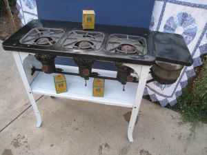

Stove picture attached (no detail of seal area, sorry)

I would say without seeing the exact set up that all the stoves that have wick burners of this type the burner is tighten with a nut or large screw head that puts pressure on usually a lead thick washer that is pretty much invisible as its under the connecting point with the burner and the pipe. The new perfection stoves use a teflon washer which is the modern replacement for the lead ones so those are available from Schwartz Perfection in Berne Indiana. Also some mail order amish catalogs carry the parts for the new perfections as well. Many stove companies made various versions of the two and three burner oookstove as they called them. Often offering a no back plain stove and some with a short back and many with high shelf full splash backs. Should you join the Kerosene Stove group, which I see the link is now working with, you would see a number of cooking stove catalogs which would show selections of these types of stoves. We do not however have a Lorain catalog in the mix at this time.

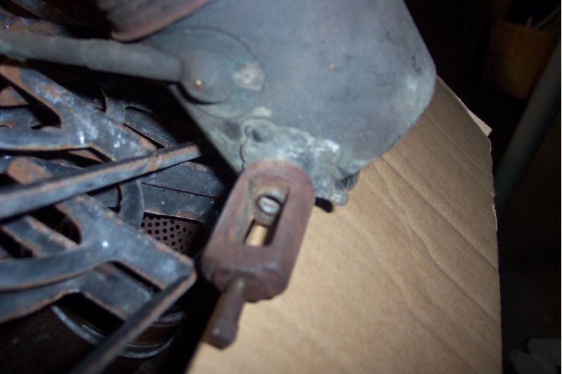

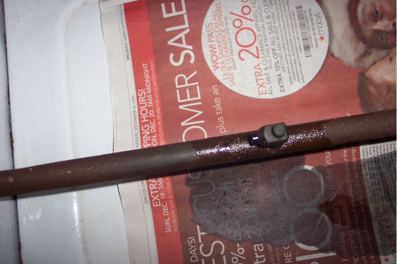

Here are closeups of the distributor pipe fitting and the mating burner. The burner (female) side looks like a compression fitting. I haven't yet tried to see if there is a good seal just by tightening the burner bolt.
I've cleaned out each burner reservoir and removed some rust for easier wick movement. If the wicks are lowered too much they get stopped before going up all the way. The don't fit between the inner and outer burner surface easily, requiring the outer shell to be unscrewed so the wick can go up to the stop. I'll see how is does when the wick is wetted with kerosene.

Well, I knew I was not familiar with that exact burner set up. Loraine was one of the earliest set ups along this line so it stands that they would evolve as they became more popular. It appears from you photos that the burner has a sideways connection instead of up and down like most. I am guessing that the little side pipe looking piece is where the burner is tightened to the pipe. Is that part perhaps soft lead? Have you tightened the set screw firmly to see if that stops it from leaking?
If not then maybe you can improvise a way to make the connection seal. I don't think any parts I know of would work on it. I don't know if a very thin "O" ring might slip over it and cause a seal when the burner is tightened? Or perhaps a light coat of a oil proof pipe dope that might cause it to seal sort of like on a water pipe fitting you screw together? Just guessing here.
Your burner is most likely full of "gunk" in the bottom from years of sitting and being used. It can change the look of the brass burner a bit, if they are brass, but the Perfection and other stoves recommended boiling the burner in a pot with Borax Washing Powder". After a while in that a lot of oily material will turn loose and running a thin knife blade around inside the burner carefully with a thin rag on it should help to clean out the sides and bottom making the wick operate the full distance. Having oil in the line will also help it to drop down. Often that kind of wick with metal carrier has to be rotated a hair to get the cogs to line up with the wick carrier. Don't force it or you risk damage to the cogs. I think once the burner is free of residue it will accept the wick. Some wicks however are difficult to get to lower for one reason or the other and worse sometimes the get stuck in the down position which is no fun. Should that happen if you run a thin steak type knife down along the carrier and sort of put a little upward pressure on the wick it often will come up.
