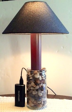

These are my primary LED lights. I use the warm white model. URL I made table lamps out of mine. I removed the bulb’s metal hanger, ran the cord through a foot-long 1 1/2†PVC pipe, and put it in an old jar surrounded by pebbles. When selecting the lampshade, take a bulb with you to make sure it fits.

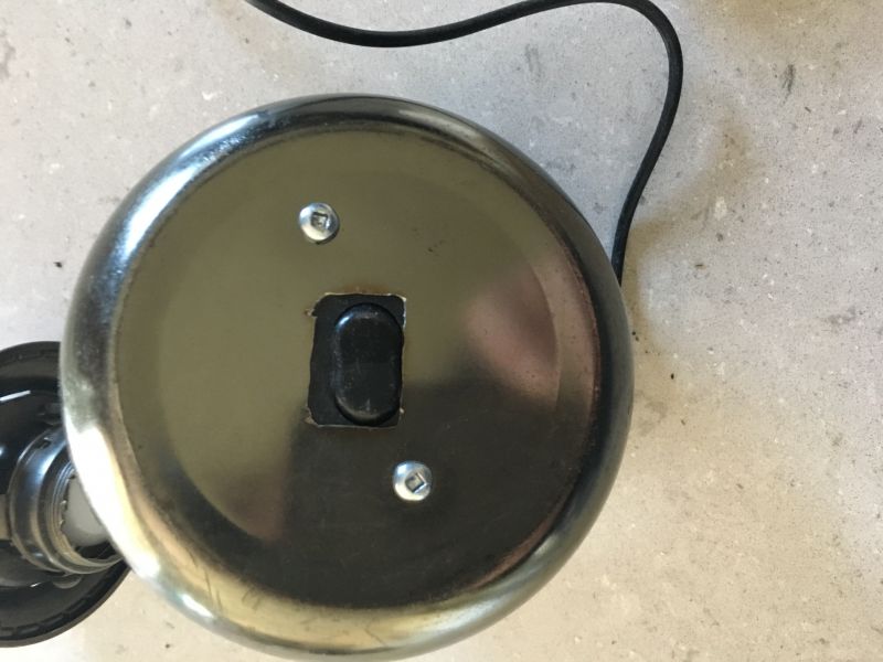

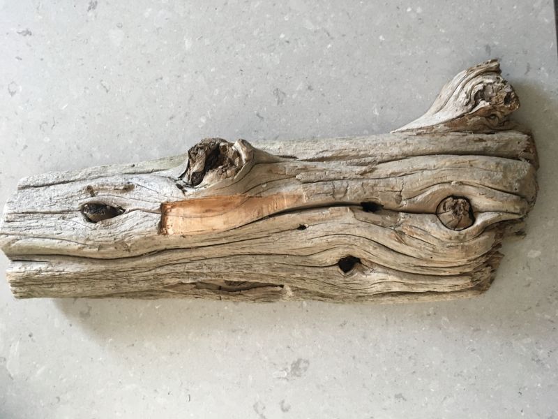

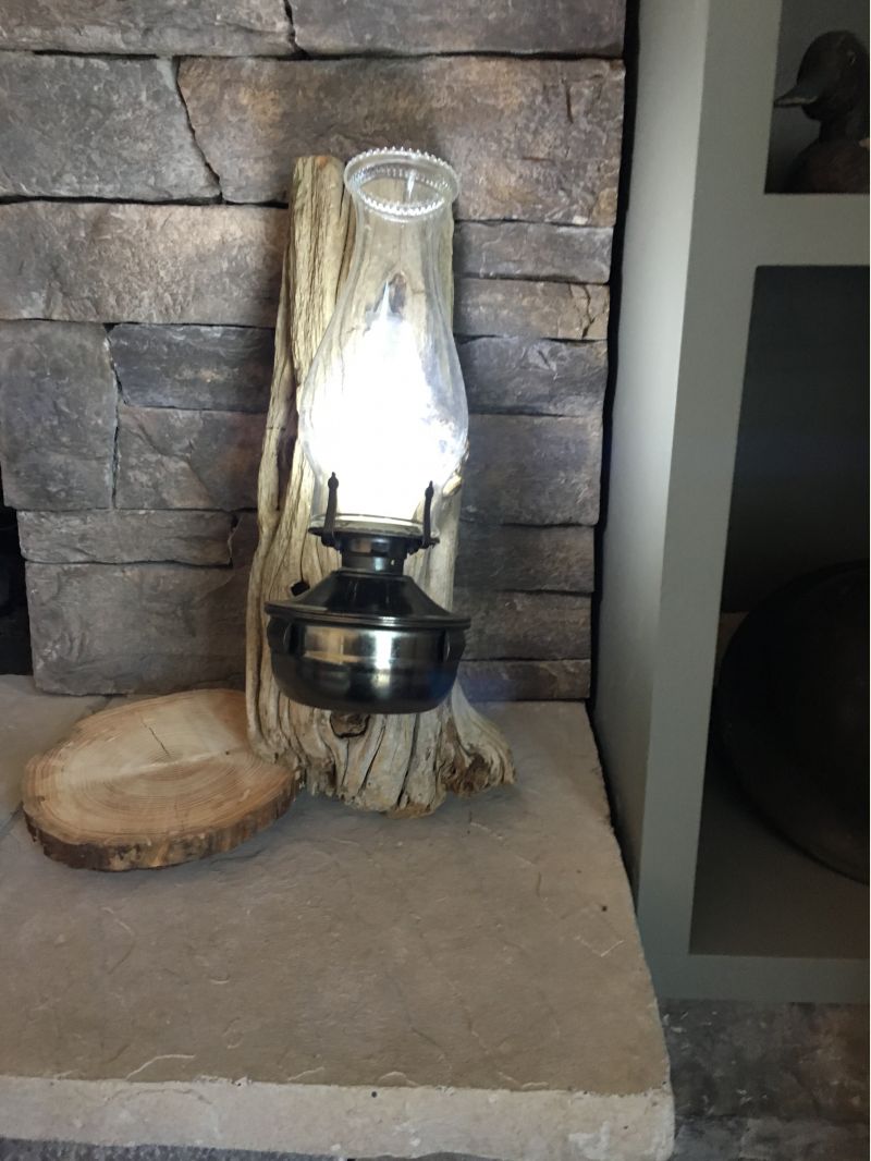

Quoting: buckybuck Over the winter, I’ve been fighting boredom by converting cheap kerosene lanterns
Hey buckybuck thanks for the inspiration. I took a 100 year old split rail fence piece, an old oil lamp, an led bulb and battery pack and made a nice lamp for my place. Components
|  Wood
|  Switch
|  Finished Lamp
benny8
# Posted: 5 Apr 2017 04:19am
Buckybuck-Thanks for the information. We are building a small cabin this spring/summer and were looking for ideas for lighting. My wife and I like projects and your ideas were great. Thanks for sharing.
rachelsdad
# Posted: 5 Apr 2017 05:16am
Kel,
Very nice. Where did you find those bulbs & switch??
rachelsdad
# Posted: 5 Apr 2017 05:18am
fitzpat: what do you run off the ankers...and what sizes do you use?
KelVarnsen
# Posted: 5 Apr 2017 06:59am

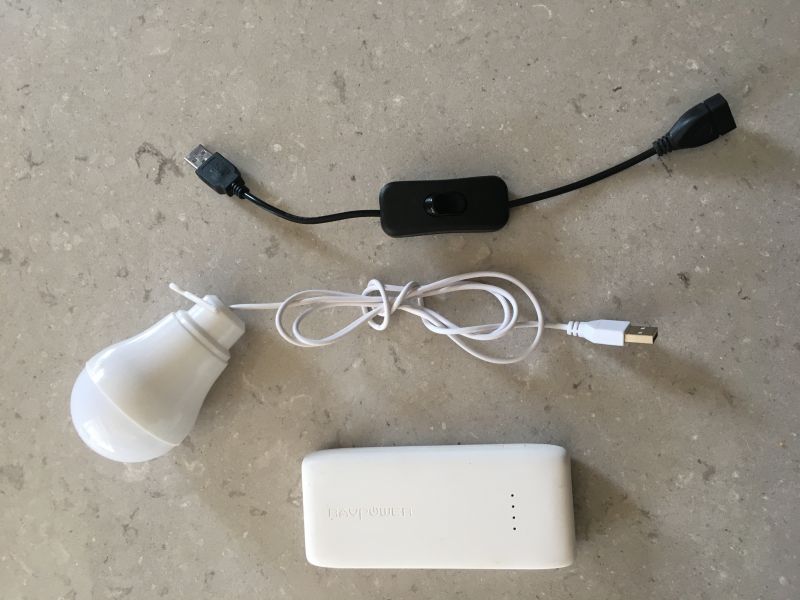

Quoting: rachelsdad Where did you find those bulbs & switch??
I found the components on Amazon. The bulb is very cheaply made. If I did it again I might find a different USB bulb, but they are hard to come by.
LED Bulb, USB Power Switch
Just found this combo too.
