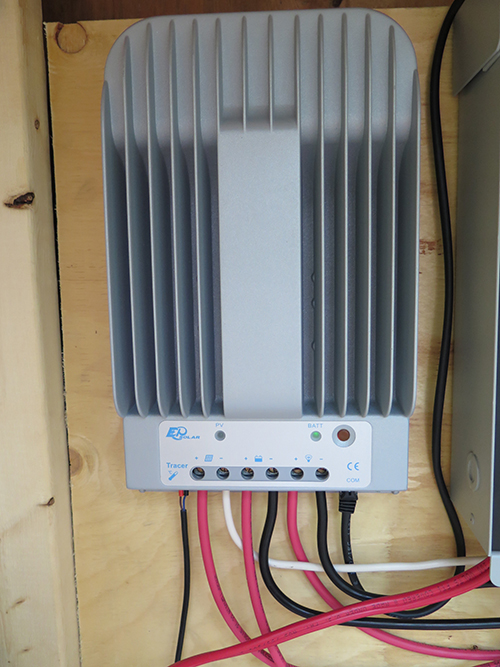

I am currently using the tracer 4215BN 40A model on 520 watts of PV. Been using it for 2 years and have no complaints. It is a China made knock off but sure delivers. The reviews are generally very good. The cost difference for me was about a $600.00 saving, thought I would try it out to help off set the total cost of the system and to get up and running on my first solar go.

Hey Clipper, is that BN programmable?
I've liked the look of these, but have always wondered. Do they upgrade the firmware? Are the charge variables programmable?
Clipper
# Posted: 19 Feb 2017 07:54pm

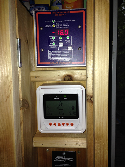

Hey Creeky, yes it is fully programmable with an MT50 remote unit. The remote unit is a must have. Apparently you can upgrade the Firmware (I haven't) there is a good (bit of Chinglish) manual that comes with the remote and main unit. I am impressed with it so far, nothing fancy but it is a workhorse.
