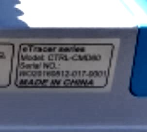

I don't know about the company, so I'll leave it at that. The solar system has a couple of things I'd point out...
They advertise this as a 12,000 watt system...
8x100w panels, no mounting hardware of any sort
Inverter: Brand ??
Output Wave Form Modified Sinewave
Input voltage range 10-15 VDC
6000 watts continuous power
12000 watts peak power
Solar Controller appears to be an 60a eTracer by EPSolar, see attached zoomed clip from their ad.
Product link: http://www.epsolarpv.com/en/index.php/Product/index/id/497/am_id/134
Batteries ? 8x 12v Flooded Lead Acid ? or and no brand ?
Talk to them and see if they can give you the specific details on parts, plus rail / mounting kit etc... Then compare a few other "kits".

# Posted: 25 Feb 2017 08:38pm
run for the hills.
that system is old, worn out and ugly. and you haven't even installed it yet.
its 600 bucks worth of panels. 250 solar control.
and I wouldn't touch the batteries or the inverter with a 19 ft pole.
Don't even go see the system online again.
thanks for showing us how scary the web can be.
