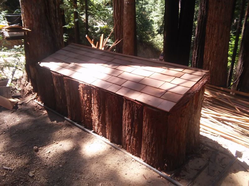

# Posted: 19 Jul 2018 06:13pm
I have so much wood scrap from my never ending deck project that I finally had to take yesterday off and build a firewood box. Yes, the lid is a bit heavy, maybe some hatchback struts.. Anyway there is no floor, it's sitting on an old steel railing, I thought it might be good for air circulation. So, before I fill it up, should I raise it up on bricks a couple inches off the dirt?

# Posted: 20 Jul 2018 09:21am
Quoting: paulz Or do I just build a box with a door..
Quoting: bldginsp make it totally enclosed
no
have at least one end, exposing the cut ends, open preferably two opposing ends
unless you have completely cured wood...even then, not so advisable
# Posted: 20 Jul 2018 01:42pm
What Gary said. The wood storage needs to ventilate so that moisture coming off the wood can escape.

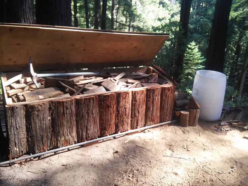

# Posted: 20 Jul 2018 03:02pm
Well I filled that up, plus a barrel. This is just kindling, board ends and scrap, 30ft from the cabin. My rounds, splitter and logs are down the hill on the flat by the road, I have to haul that up as I burn, no room up here. That's all out in the open, need to build something there. Well ventilated, point taken.
