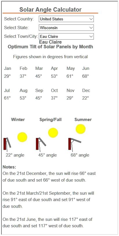

 EDIT:  Here is a link to a Angle to Roof Pitch converter so you can figure out what roof pitch would be best for you.  It appears a 45deg or 12/12 is the median, which is a pretty sharp angle.
 http://www.blocklayer.com/pitchangle.aspx
 NB:  Enter the angle value and click the [angle] button which will provide the rest of the numbers.
 ATTACHED is the Optimal Solar Angles for Eau Claire WI
 |  Eau Claire WI Optimal Solar Angles

 The ground mount would be stationary, I refuse to use a tracker. I've seen 1 crumble to the ground do to high winds,even with a concrete sonatube structure. The math tells me that 26*-30* will produce more power during the summer months because of the longer daylight hours. So I think a 4/12-6/12 pitch roof would be ideal for roof mount.
