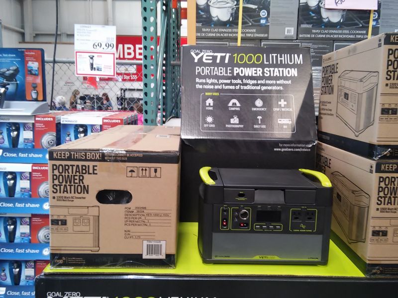

Small Cabin Forum / Off-Grid Living / Yeti 1000 at Costco
# Posted: 10 Mar 2017 09:44pm
$1,000 is the price. So what do you get, batteries and an inverter?

Seriously I didn't know what these things have inside, thought maybe a nuclear reactor. Costco will likely sell every one. To cabin guys, not so much. Looks about the size of a milk crate. Hmm.
# Posted: 12 Mar 2017 12:32pm
I suspect its a battery, a battery charger and an inverter all rolled into one unit. Its nice for what it is, but its spendy for what it does. It might be a neat idea for power int he evening after the gennie is shut down. When I shut my genny down in the evening, I am going to bed anyway.
If it was me, I'd spend the 1000 on the EU2000i and then consider the Yeti as a secondary power accessory, but not as a primary. In other words, I would not get it unless I had the Honda already.

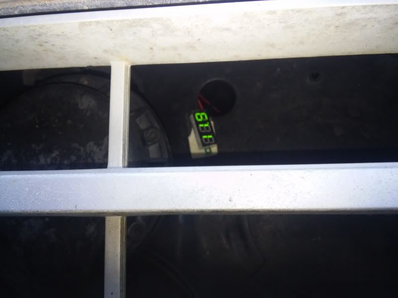

I have a deep cycle aux battery in my truck. It has been powering lights, tablets, wood stove fan, radio since yesterday. Getting low but by the time I drive home later it will be charged.
