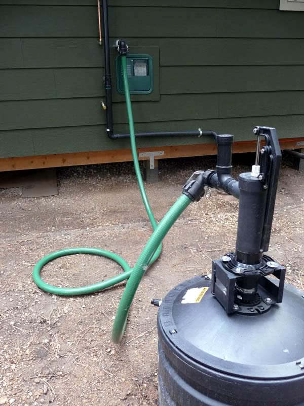

We use a RV type water tank under the kitchen counter along with an Shurflo RV pump (12VDC) to supply water to the sink and shower. There is no pressure tank, the pump has a sensor that turns the pump on and off when a faucet is opened and closed. It does require some power but I like it better than depending on gravity. Gravity flow gives you 0.43 PSI per foot of elevation difference from water height to point of use.
I have a 1.5" diameter hose connecting the manual pump to an inlet fitting on the cabin wall to fill the tank. I ran a vent pipe from the inside tank out the wall. When I pump the tank full I can tell by the sound of the displaced air when the tank is full. With the small elevation difference from the pump to the tank it has not been necessary to use a backflow preventer. In freezing weather though the hose must be drained between uses though.
this was before I trimmed the hose to a usable length
