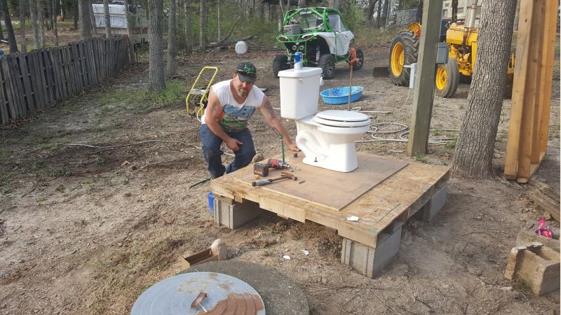

At my lake community, I have a good friend. We are about as opposite from each other as 2 white guys can be. I am a standard suburban subdivision guy, and my buddy is as down-home backwoods as you will ever meet. After years of trying, he finally got the guy who owned the adjoining lot to his to sell. It has a well and septic, and the family hadn't been down for years.
The first thing my buddy did was build a flush toilet outhouse. It is right over the septic tank, and he just ran a straight pipe down into the tank. Its in no way pretty, but it works great.
Tim
terlet
terlet
Bigred292
# Posted: 28 Apr 2017 01:37pm
Quoting: Cowracer
Not much privacy

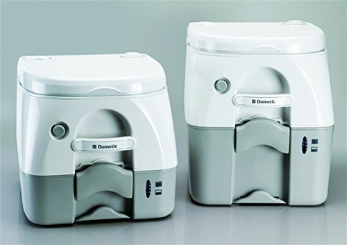

# Posted: 29 Apr 2017 03:13pm
Here is what I've been using at camp for the last five years. The Dometic on the right. It's the five gallon holding tank model. The push button is the flush. It's works by pumping up the toilet about once every five days. It's $106.00 at Amazon.
No pump to break. I leave it at camp. To winterize I dump out the water and put in winter windshield wiper fluid and run it through the toilet. Never a problem. I also have one in my F150 since I do a lot of traveling alone to remote places without bathroom facilities.
